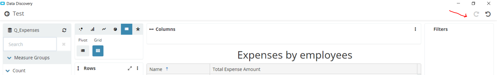

I just discovered Epicor Data Discovery and I’m trying to create a report/dashboard by adding my custom views. I manage to create my table but I can’t save it anywhere. I saw on a video that there should be a save button to save my view on the top right of the page but I only have an ‘undo’ button. Can anyone help me ? Is there a permission missing ? (I have almost all rights on my user account)
Finally, I got it working by clicking on the parameters and adding the ‘Designer’ role to my account. After that, I logout and login again and I can save my view. But I can’t add any view, it seems to freeze and bug when I do so.
