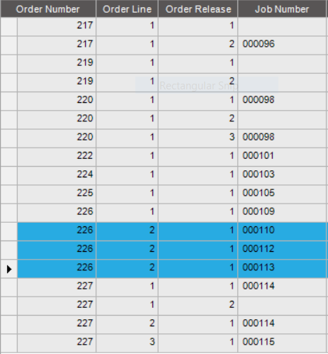

I need help to display multiple job numbers against a single release of a Sales Order using comma seperated values in a single row
Here is the Query From my BAQ:Pending_SO_Dashboard_Test.baq (41.6 KB)
Job%20against%20SO
Output of the Query is attached in an image and I need the highlighted Fields should be in a single line and a single column using comma seperated values.
