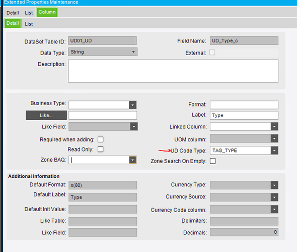

I set the UD Code Type of a field in the extended properties but it doesn't show as a dropdown when I add it to a form
I created a UD Codes Type and set about 20-30 active codes. I created a UD field on the Ice.UD01 table (because for the fields that are already created UD Code Type is greyed in Extended Properties). I set the property to the correct UD Codes Types. I have a customization on JobEntry where I added UD01 has a Child Table to JobMtl. It worked great and I see the field but I expected a dropdown with the User Codes has values

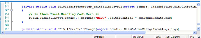

Adding a EpiComboBox to the grid is fairly easy, all you need to do is make the control (the dropdown) not visible, then bind it to the grid.
In this example, we are binding the epiComboRebateProg control to the Key2 field in the grid.
rGrid is a reference to the grid on the screen, obtained similar to this:
rGrid = (EpiUltraGrid)csm.GetNativeControlReference(“8d65c88b-6b55-4c72-8b09-337fe16447c6”);
(obviously, you’ll have a difference guid for your grid)
