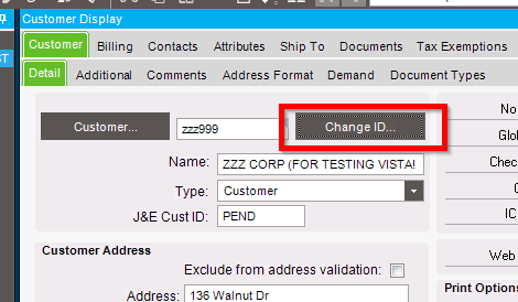

I assume this is related to the “Customer Display” form. If so, the CustID field is used for retrieving existing customers, not changing the loaded customer’s CustID. To do that you use the “Change ID…” button.
Entering a different CustID in to the Customer field will just load that other customer into the form. And if no customer sexists with that ID, then it asks if you want to make a new one.

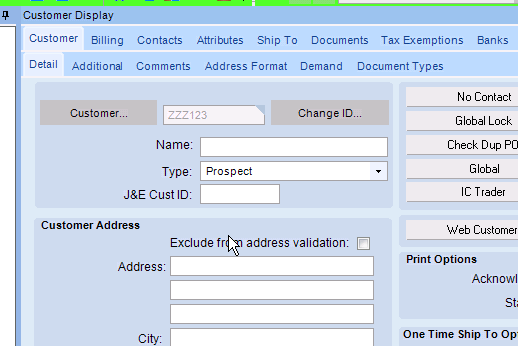

I just did a quick test and you can set that control’s enabled value to false, on a button click
The following is after selecting new customer, entering the target CustID, and then clicking a button.

Here’s the code that disables the CustID field
private static void btnNewCust_Click(object sender, System.EventArgs args)
		EpiTextBox CustID =  (EpiTextBox)csm.GetNativeControlReference("3a3fffc1-6dee-4be0-b52e-7fc5f80e7b95");
		CustID.Enabled = false;
Put that CustID.Enabled = false; right in your function, right after it sets the value.
