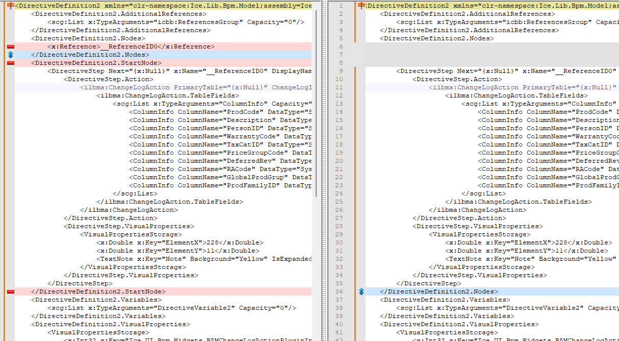

The only thing I’m stuck on now is identifying differences for directives that exist in both environments. I’m comparing Body, but just about all the directives seem different in their Body in the manner below relating to startNode at least, I assume something to do with bpms being created in one environment and solutionized in the other.
(Not able to follow this)
Doesn’t seem to be an easy way to look for actul C# code differences which is what I’d really like.
Hmm looking again I think if I filter out certain lines eg any lines containing StartNode or
<x:Reference>__ReferenceID0</x:Reference> or </DirectiveDefinition2.AdditionalReferences> then compare I might get some joy.

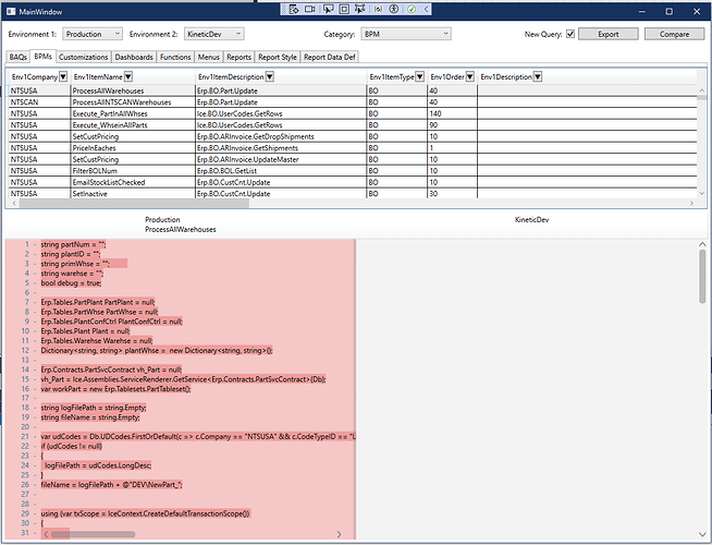

Don’t know if that will help or not, but it worked for me. The ItemContent field contains the C# code. I guess I should also clarify that I was NOT pulling the information into any Epicor related. This was part of a WPF program that I did in Visual Studio, (the first time I had ever done such a thing, so it’s pretty ugly.

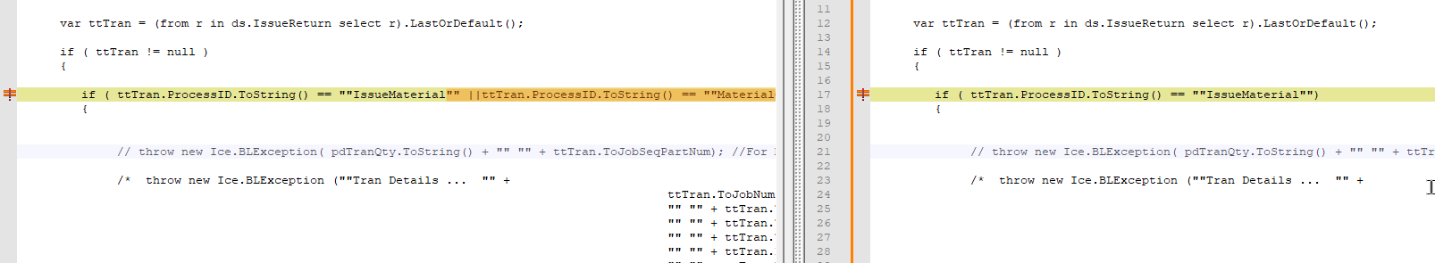

63 BPMs identified where the code differs in our test and development environment to our pre-go-live basedata environment. A win for epiusers, a loss for our Epicor go-live program…
eg
