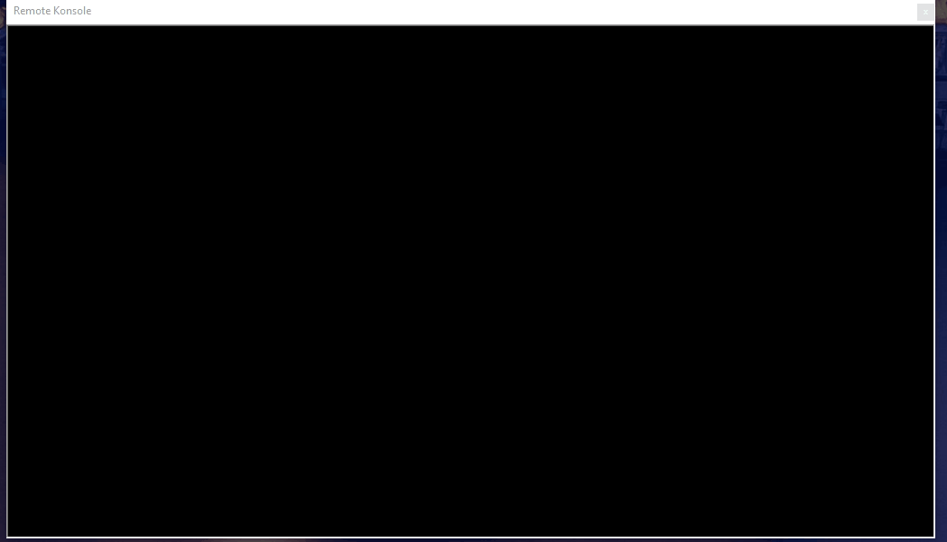

Here is a little demo of Konsole:
KonsoleTeaser

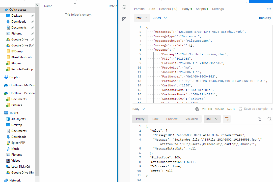

And here is an example of it working (via postman)
BTQuickDump
