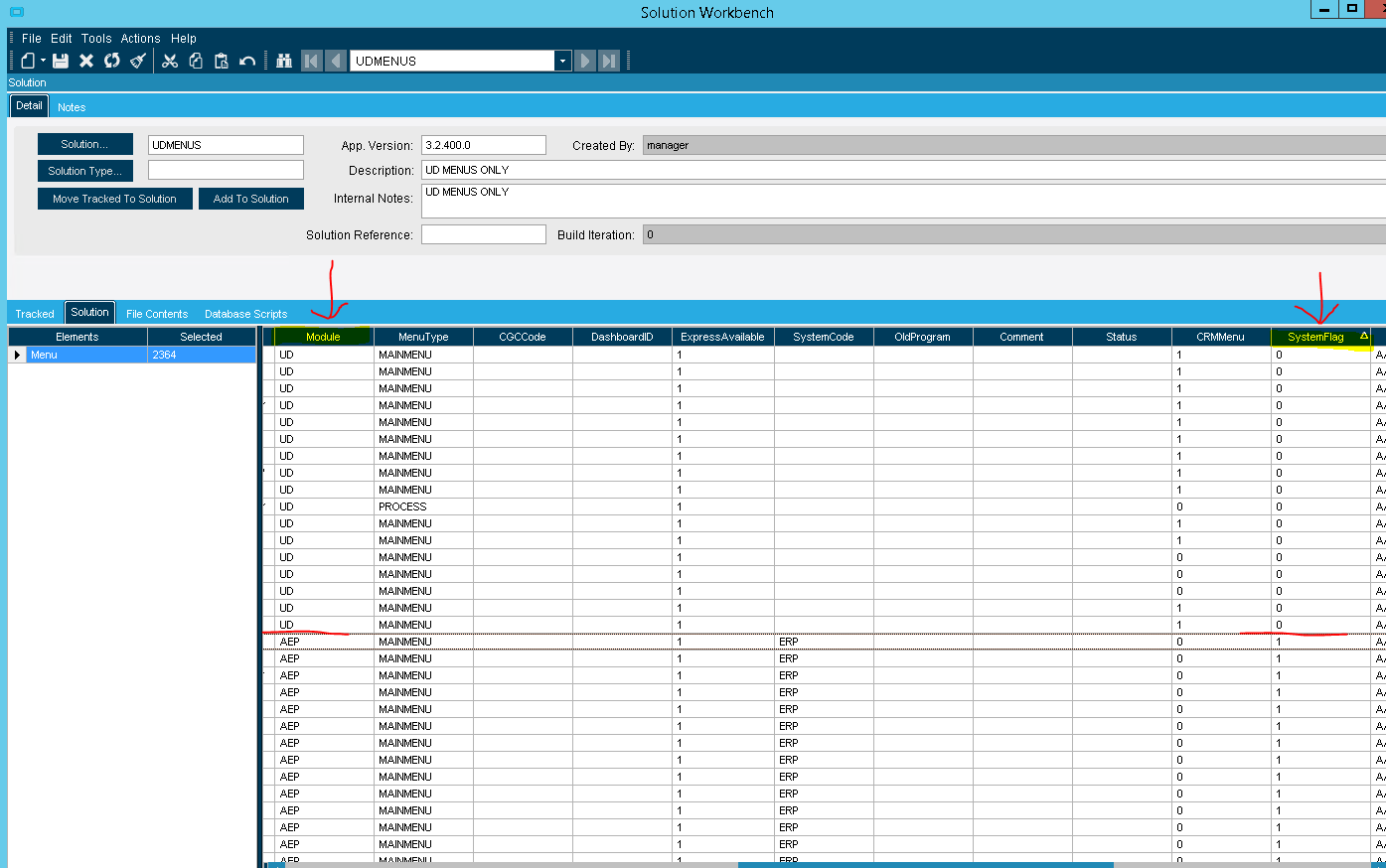

I think you can change the Module for new “custom” menu items. So the best is to look at the SystemFlag field of the Menu table.
The Menu items and most of custom components have a SystemFlag field. If SystemFlag = 0 then it is custom (UD).
You can SQL, BAQ or Add items to Solution Package and see them there.
Example:
Also if you are looking for Menu Items where you have a Customization Applied you can look at the Arguments column, I assume you have your Customizations prefixed, if so it will make it even easier to identify with a LIKE '%prefix_%'

I think my query is correct…here’s what it looks like.
