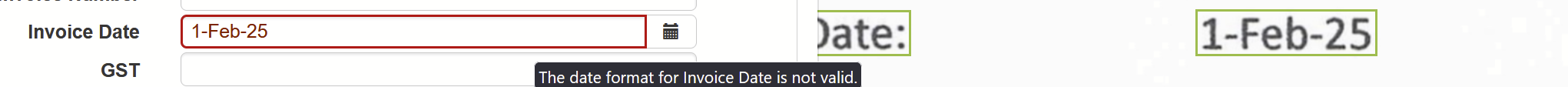

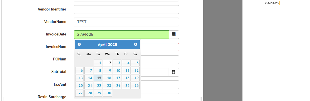

For some reason, dates with a two-digit day are accepted, but single digit isn’t (so 22-Apr-25 is fine, but 3-Apr-25 is not).
Has anyone come across this problem? Screenshots included:
Doesn’t work:

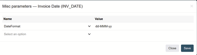

works:

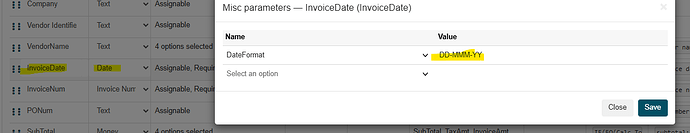

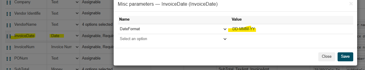

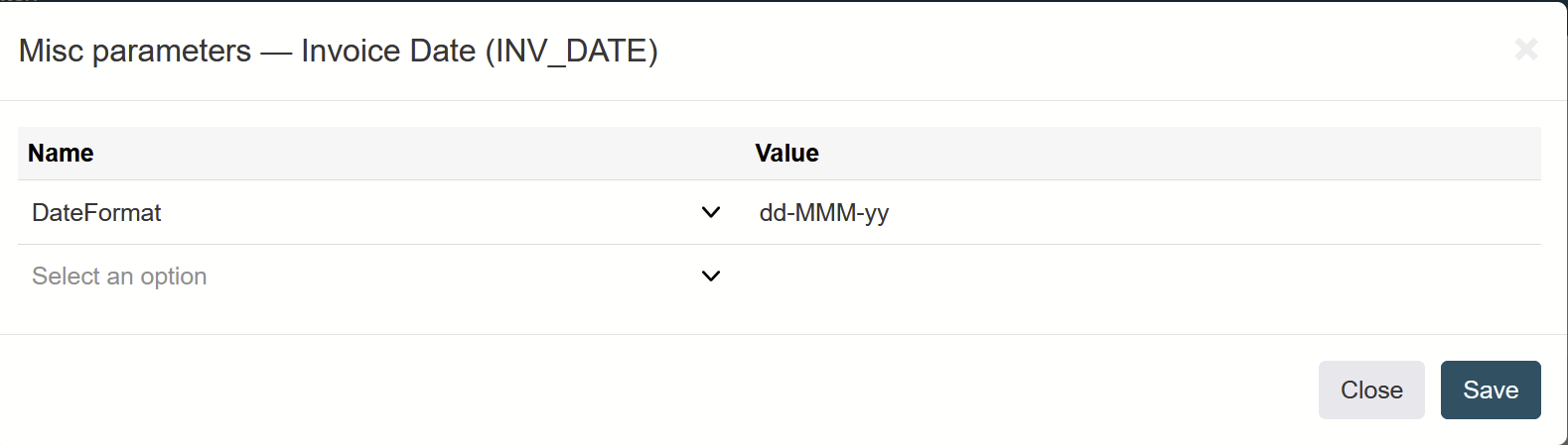

When I tested this, I found that this format works with the DD-MMM-YY format in the Misc parameter. Your batch type locale may be causing a conflict with the date format.
I have a Misc parameter set up for it already though:
Don’t misc parameters overwrite Locale settings?

DD-MMM-YY - I would use this format in the Misc Parameter and see if that resolves it.
No luck
Note I also tried D-MM-YY to no effect

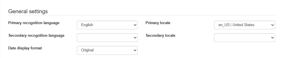

My batch is using en-Us locale, the possible issue could be the locale and you can set that on the misc parameter to resolve date format issues.
My locale was set to en_CA as Primary, and en_US as Secondary. Anyway i changed it to US primary only, and it still has no effect.
On yours do you have the date format set to anything specific?
I have it as MM/dd/yyyy because that’s how the customer needs it. My understanding was that the DateFormat parameter allows for exceptions to this and enables the ‘translation’ of the date to MM/dd/yyyy?
The secondary locale does not work on the date formats.
These are the settings I have in use.
I haven’t done anything with the Date Display format other than keep as Original.
