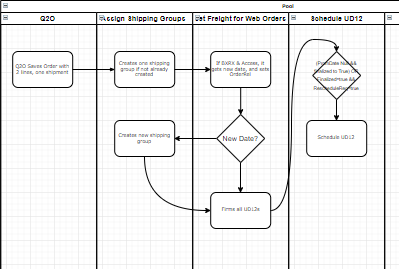

Another tool I have used for more complex flows is a simple free drawing tool available here: https://www.draw.io/
