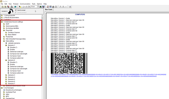

What barcode scanner do you have? Some have a DataWedge or EasySet app you can configure your handheld to do exactly that. We use it often to ignore AIAG Label Prefixes.
I thought the same thing for skipping prefix/suffix… but I believe the original question was about skipping something in the middle of the part number. That would seem to need more like a little more logic-based solution such as a BPM.
Hi @hkeric.wci We are using the Honeywell CT40. I am trying to configure to delete the middle section of the barcode with no luck but I really am unsure of what i am doing with the EasySet.
Hi, Is there any way of configuring the Honeywell devices to remove the digits if the barcode is 18 digits and starts with an S using this EasySet? Whatever i try does not seem to work.
It’s been a few years but mine looked like this:
Perhaps using Compose Barcode length. I wonder if Honeywell has some better Tutorials somewhere.
But its my understanding you can do exactly what you want, Take Characters, Move Characters, Delete Characters, etc…
Hi @hkeric.wci the EasySet does look like it does what i want it to do but i cannot set my device to use the settings. I only need 2 scenarios One for barcodes with 18 characters and start with S and one for everything else.

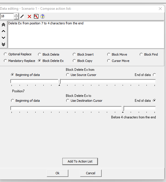

Hi, I managed to get this sorted by contacting Honeywell Support.
They created me a barcode FOC that i can scan to change the settings.
If anyone needs to use the barcode as a template to do their own thing i have attached.
This barcode does the below:
  • Checks the barcodes starts with a prefix of S
  • Checks the barcode is 18 digits (including prefix)
  • If the above is true then only read the first 6 and last 4 characters.
