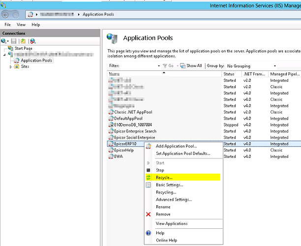

OPTION 2 - IIS Manager GUI:
- On your Epicor IIS server, click the Start button(or open a Run line) then type âinetmgrâ without quotes and press Enter.
- Expand the name of your server, and click on Application Pools.
- Right-click on EpicorERP10 and select RecycleâŚ
