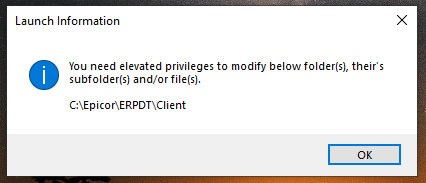

Our clients kept on crashing all day on Friday before the upgrade with very limited help from the help desk (they were never able to fix whatever the issue was) and now I am getting this error:
Make sure there are no versions of the client running including EpiEOBrowser.exe in your Task Manager.
No versions are running. I am first getting this message when clicking on the smart client desktop shortcut:
Right click run as an admin.

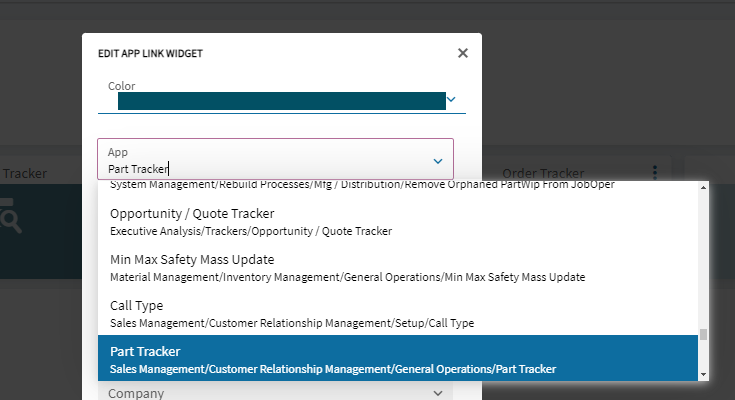

We upgraded over the weekend. The main issue seems to be that the default kinetic layout, or menu or whatever you call it, is not letting folks use forms they use all the time. When users try to click on the job tracker (for example) they get access denied. However, they can still search or use their favorites. I suspect that when we first setup our permissions we set them up in a way that worked for us, but was different than what Epicor expected.
Edit: I also had to redownload and reinstall Epicor on a couple of computers. I had those same folder permissions issues. Run as admin and updating to the newest download version seemed to work. Obviously, you have to close Edge Agent if you have that running.
Are you talking about the widgets on the homepage layout? They are pointed to a specific instance of that menu. So the Part Tracker widget is pointed here:
But if they don’t have access to Sales Management/CRM, etc… they’ll get the access denied.
The menus that show up in their LIST… they have access to. But widgets in your layouts are pointed to a specific instance of that menu and they could be point towards one that a specific user can’t access.

I repointed mine to a known classic menu. They still don’t work.
I can launch the same menu from the main menu.

I had to reinstall to get it to work.

I deleted the tile, and made it again as new.
It now works correctly from the home page.
