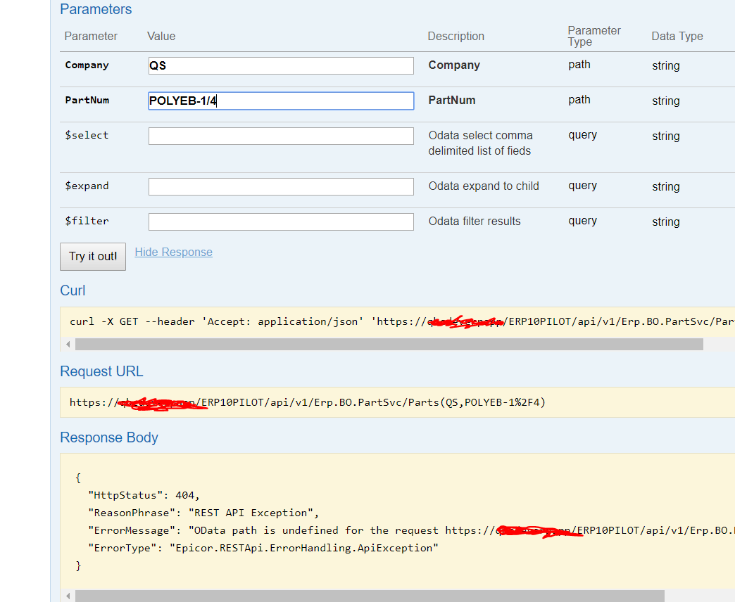

I'm using the Epicor REST API and I have a problem with a PartNum that includes a '/'
I’m using this request: Erp.BO.PartSvc/Parts({Company},{PartNum})
The problem is that some of our parts have special characters such as ‘/’ in their code. It causes a problem when I try to verify if it exists via the REST API. How can I do this?

Are you URL Encoding your call?
I tried to use urlencode but I had an error returned
Even in the API page, I can’t get it to work
i’m sure the swagger UI will not like it, but what error are you getting when you try on postman while encoding the url

Finally, I found a solution.
In GET /Parts in the parameter $filter, set the value to: PartNum eq ‘POLYEB-1/4’
