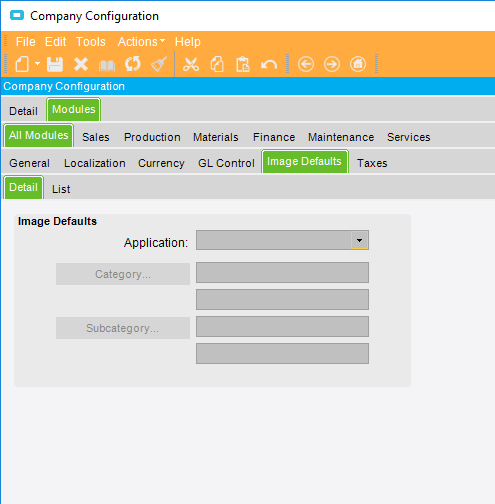

You have to set them up in Company Config

tks for the reply…but this is to setup default category per application…
for instance: Employee maintenance would probably have a Employee category…Part would be different…
It is not indicating nothing else…How I understood it is : categorizing the images would make the image be saved in the folders named with the catgegories…
I did not setup the default categories… and was able to add a dummy file image to my part without any category selected…

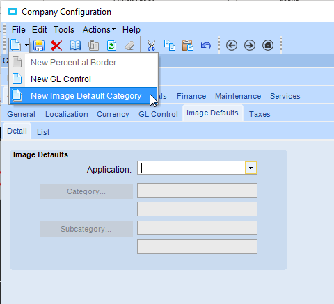

Hey Matt,
Did you try New…
I’m SaaS too (Public Cloud DT) and it opens up for me.
Mark W.
Nice! I hadn’t thought of that. Now to find some documentation on proper use of this! Thanks Mark!
