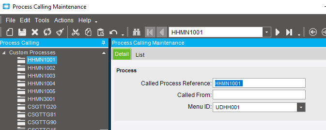

Just putting this one out there, but has anyone seen a situation where you go to import custom processes in Process Calling Maintenance->Actions and the resultant processes have nothing in the Called From field?

That’s interesting. I would have thought if you were importing with the field populated from the export environment it should have imported. You could argue that it’s splitting hairs, maybe I’m just a bit OCD. Thanks for your reply.

The program Id was Erp.Menu.Handheld. It even shows in the XML of the export file, just does not import. The destination menuIDs were created prior to import.
