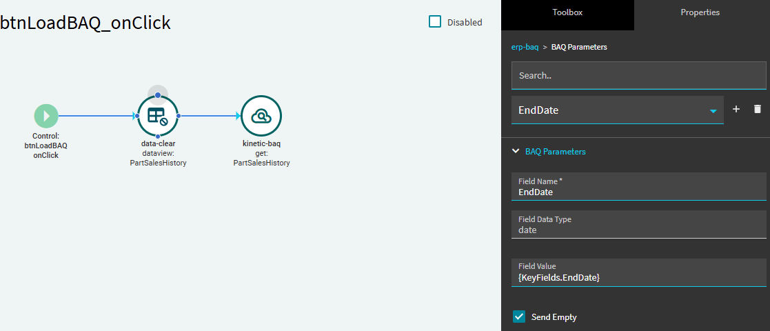

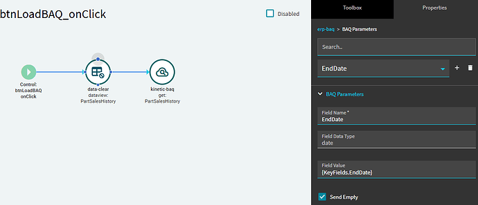

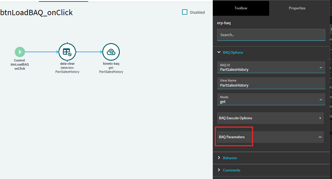

What I typically do is I use an event for that instead of mapping the dataview directly to the baq. Leave the dataview blank and create a new event that uses the kinetic-baq widget. In there it will let you specify the parameters for the BAQ, and it will let you map the baq results to your dataview. The screenshots I have are triggered by a button that loads the information from the BAQ, but you can also set the trigger to be when the app loads (type: Window, hook: On Load)
Oh thats interesting! I think this way you can also switch BAQs based on user input in case you need to show different data (Like closed orders vs open orders coming from two different BAQs)
Yeah, I’ll use this setup when I want the user to be able to filter a BAQ with different values for the parameters. Most commonly for me it tends to be when the user wants to be able to filter a range of start / end dates for large data sets, but you can definitely tie it to a field that lets them toggle between open and closed orders.
