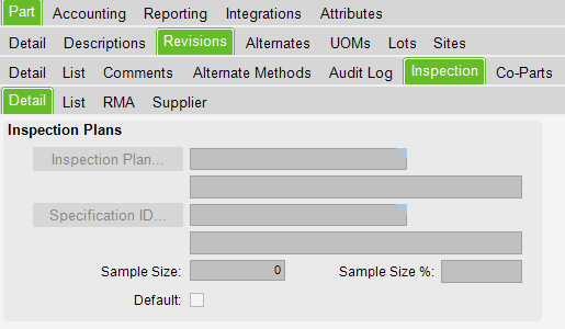

I could be wrong, but my understanding is that you enter the sample size on the Part.
This is what will provide the sample size when you click on the Generate Test Set in the Inspection Entry screen. I don’t think you can set Epicor to do an every X. This would take care of your sample size.
For the actual inspection during the job, you would need to put the Inspection Plan on the operation or material. I’m not sure how you handle the sample size through the job though. It might come from the Part, but the company that I was working at shut down before I got this far into the process.
