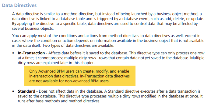

There’s a diagram somewhere that explains it better, let me see if I can find it
Page 548 of the Epicor ICE tools guide (for 10.2.600)
In-Trans: You still have the opportunity to change data BEFORE it gets written to the DB. You can also abort the transaction if desired at this point
Standard: The data has already been written to the DB. You cannot stop or reverse the change. it is done. but you can act on the fact that something has changed, and do some other action such as: update another UD Table, Send an EMAIL, etc.
