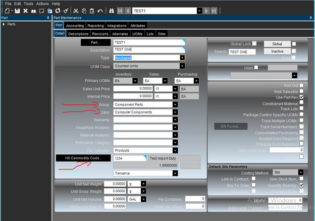

As shown below, I created a purchased part and assigned it to a Group, Class, and HS Commodity.

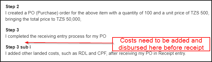

As Zach has said you need to disburse the costs if you havn’t. Other thing from you process above it looks like you may have added the costs after the receipt was made.
All costs need to be added and disbursed before the receipt is made. If not anything added will go to variance. If you don’t have the costs before receipt you can add an estimated cost and reconcile after you get the invoices to get most of the costs onto your parts.
Also check your costing method on the part. landed cost works well with AVG costing to update the part costs and run against the Gross Margin reports but it looks like you are using STD costs based on your part setup. I believe you would need to do a cost update on the STD cost after the receipt.

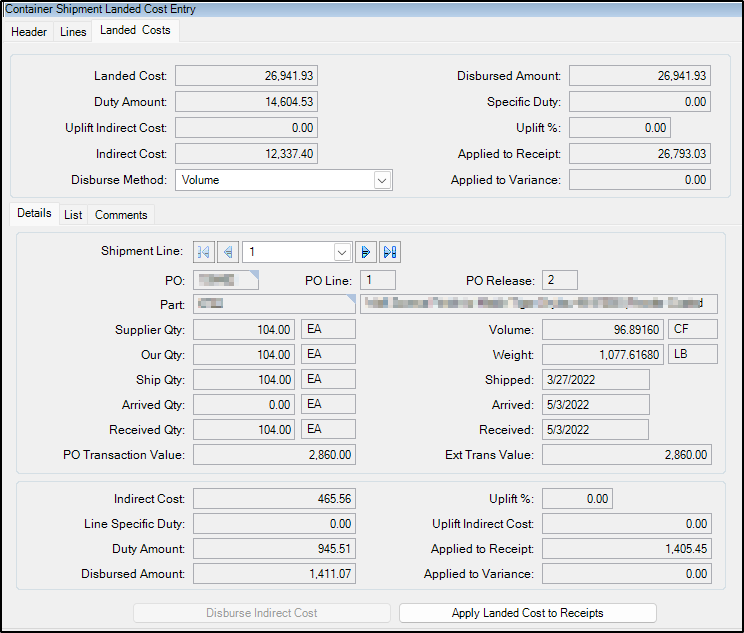

Can you show me the Landed Costs tab from Container Landed Cost entry from your test?
