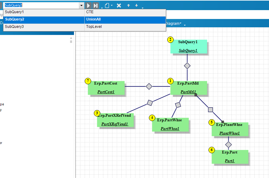

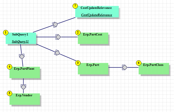

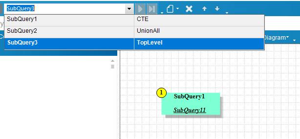

For reference, here are my 3 subqueries. What do you recommend I do with this? Move everything from Subquery 1 “CTE” to my SubQuery3 “TopLevel”?
Yes.
For everything you include in the CTE you have to include in the union anyway. You’re making it do all those extra lookups as well recursively. Instead, move them to the Top Level and your query should be more efficient plus it will do what you need in the case of joining to PartXrefVend.
The only things you need in your CTE and Union subqueries would be things associated to the indented BOM and the level within the BOM (MtlPartNum, ParentPartNum, ParentRev, MtlSeq, hierarchy, PullAsAssembly, etc.). Everything else can be brought in after in the top level.

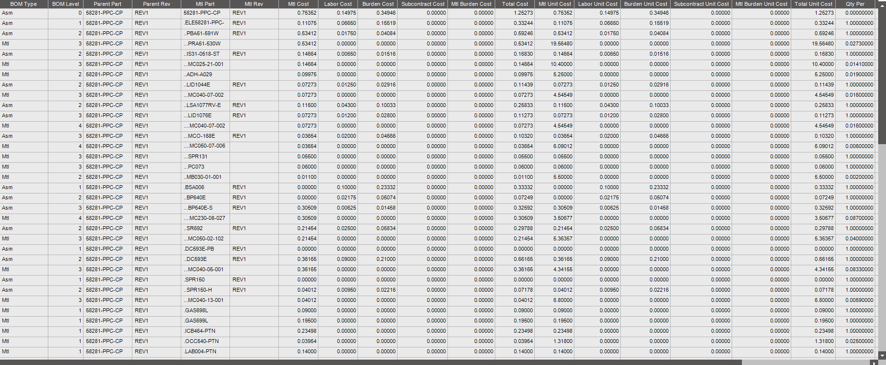

Hi @Anthony_Mattice thanks for the BAQ, I’ve tested out but is there a way to do like the screenshot below?
DA-IndentedBOM1.baq (208.2 KB)
@Ziqqie_ringstorm Would help if I were to share the right BAQ lol. This should work. Its a hefty query and I’m sure it can be optimized in spots.
