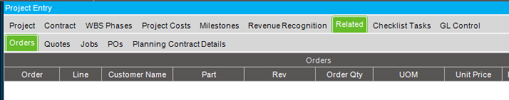

Actually sounds like you could use Projects for gathering these things.
:thinking:
That crossed my mind too, but am not that familiar with the linking that would do. Can you link Projects to Projects?
Initially I was thinking that your project ID would be the machinery SN (or it could be in another/UD field) and you could use it to ‘collect’ the other transactions like we do. Each of these transactions has a Project ID field.
We don’t fully use the module like Epicor intended, but it’s working for what we need.
Also - don’t see a way to link projects to other projects.
Oh, so you create a project and leave it open (can you add to the project if it is closed?) and then whenever there is a transaction against the SN, you link it to the project. :thinking:
Interesting solution! I’m going to have to think on that. Especially since I was hoping to use Projects as…Projects. :laughing:
yep. And you can still use projects as Projects - but the mix might make reporting a bit dodgy in so much as you’ll potentially have to exclude the machinery projects form any sort of summary reporting.

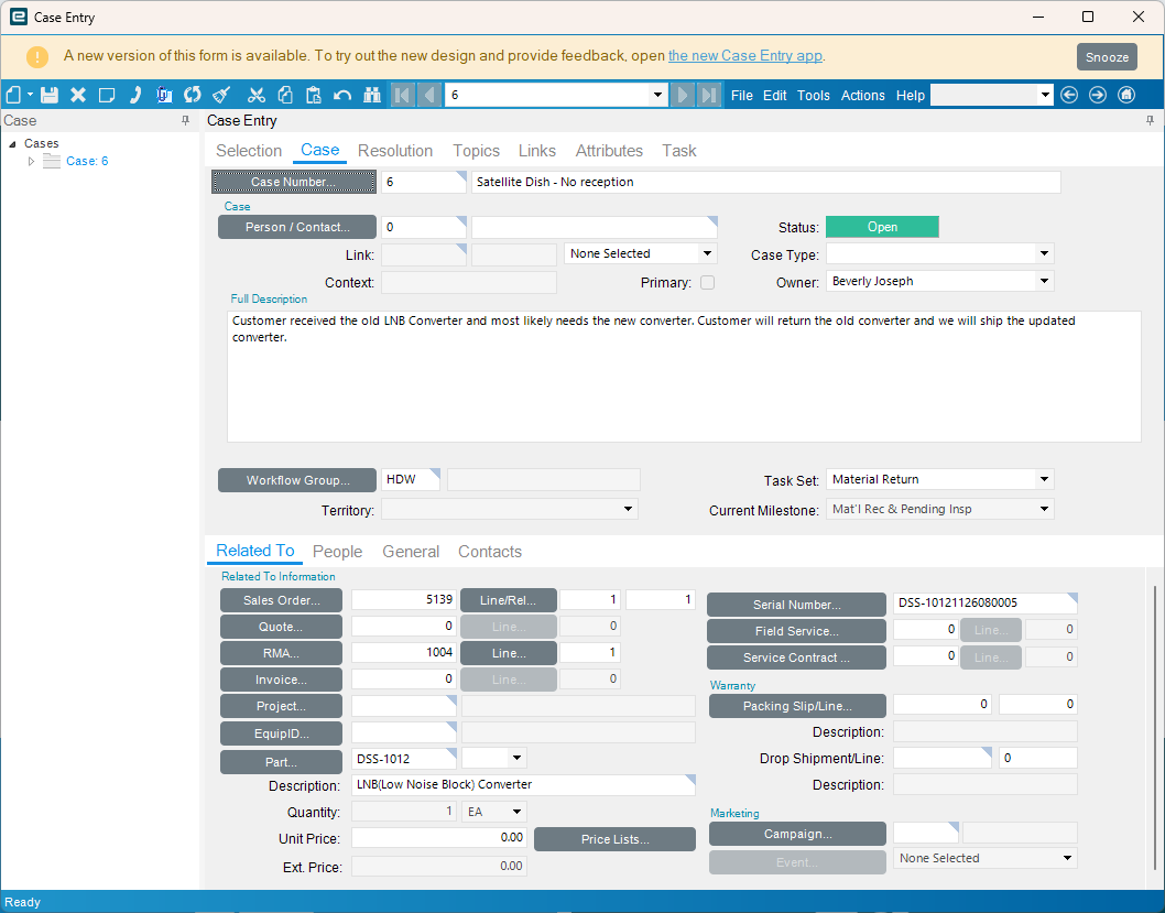

Or Case Management
Yes, that was my initial thought too. But how do you track to the top level part and SN when you are sending them lower level components?
You could use a linked case/parent case
I forgot that Case had SN field. I just didn’t think it would work because you mentioned future orders (Plural) and a Case is really a 1-to-1 relationship. It does link to other transactions, but not like the more generic Project hierarchy.
I guess that’s the only two real differences when re-tasking these two elements for your purpose - (1)do you need >1 order/invoice/job? and (2) how easy will it be to regurgitate the data (summary reporting) in some useful form?

It looks like you can create all of the links in a case that you want using the External Links. Not sure if that would be better than parent/child cases. I’ll have to play around.
