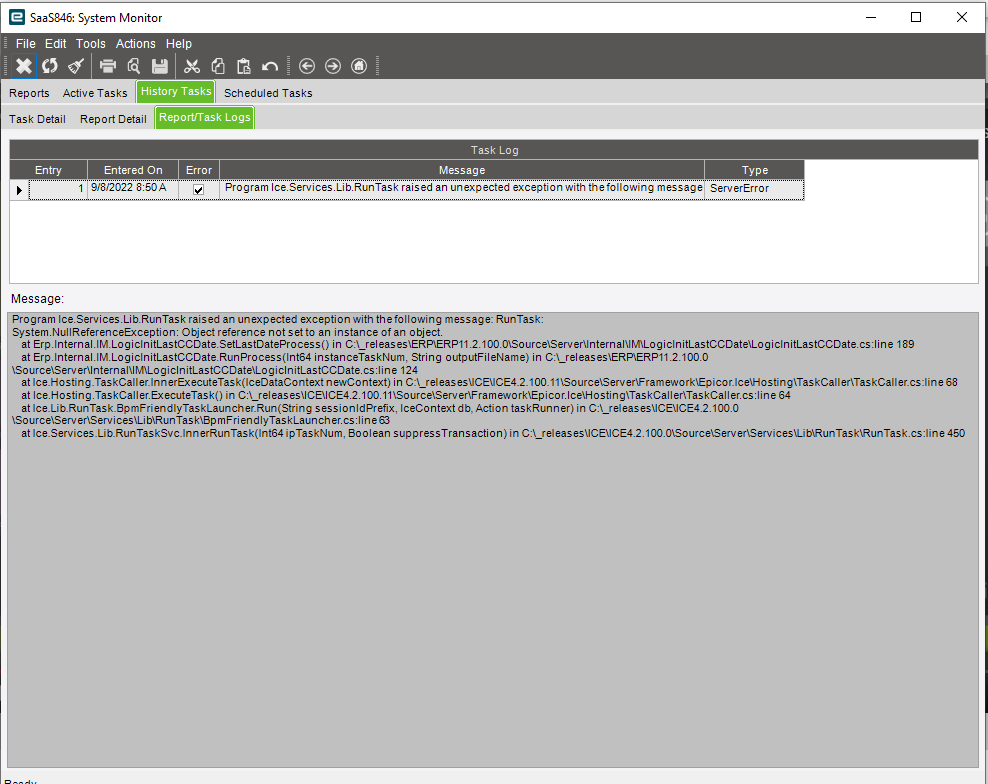

Hi Guys,
I’m trying to run initialize last cycle count date for the first time on our Live DB, but im getting the below error when I try to run it.
I went out to EpicCare and searched on their Knowledge Base.
This among other steps may help you out.
There is a program that you can request from Application Support that will clear the Last Cycle Date on all parts. Then you could run the Last Cycle Date process to estalish a new date schedule.
The issue ended up being there were some parts that had a ABC code assigned as “F” but F was not in our ABC code list, once I removed the F’s it ran fine.
