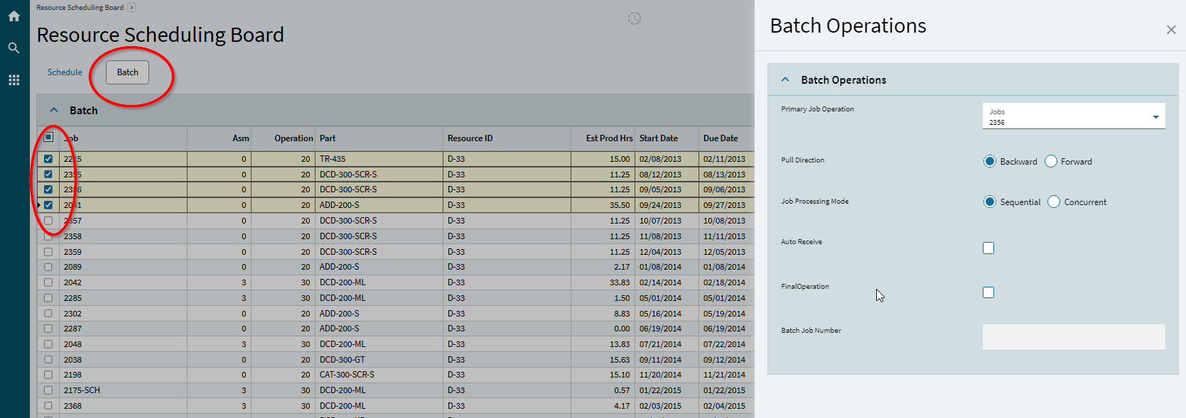

Could he use the MES Work Queue? You can check all the boxes and then start activity. That moves everything into a tab where they can check all the boxes and end work. A personalization on that screen can put the labor quantity after the job number, so the can just type the quantities in the grid.
Another option would be to batch the jobs since the operations look the same. You need a module to do that. Look at the resource scheduling board and see if the batch operations is available. Then they clock into 1 parent job and type in the quantities for each child job.

this sounds like a primary example for the use of JOB BATCHING… you can select all the jobs that need to be cut at the same time, and batch that operation together. The system will create ONE JOB that batches all multiple jobs into one (only the operation you specify). once you complete the work on teh batch job, the work automatically gets separated out to the other jobs again. You can batch jobs in the Resource Scheduling board.

“help” should have some information. It is not super complicated. you simply go into the resource scheduling board and pull up the resource that has the common jobs, then there is a batch tab (in smart client it will look slightly different, but the functionality is the same). you select the jobs to be batched, and then press the batch operations button… then a page comes up to ask you some options. Since you are wanting to batch the FIRST operation (or one of the first), you would choose BACKWARD.
I would recommend you do some experiments in a pilot database to see how it works, and try various options before doing this in production.

there should be a new job number, and you should report it just like any other job.
I have created the Batch: 308051-1-1 with these jobs
