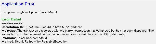

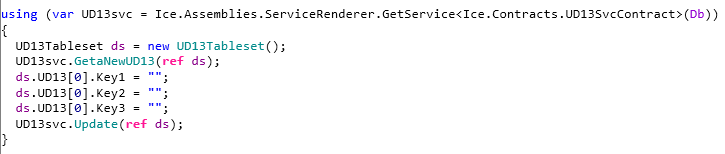

Hi,
I’ve been trying for a while to make it work but I can’t figure it out… I know this is an old post but I`m still trying to get answer here since this is the same base subject.
I`m in a data directive of JobHead (In-transaction).
I`m using the code proposed by Jose adapted to my context:
But I always get that error when running it (Trigger when JobHead.JobRelease 0 to 1):
Error_1
What am I doing wrong?
Someone got tips for me?
Thank you in advance!
Best regards,
Alexandre

I had to add a Reference to Ice.Contracts.BO.UD06 see screen shot. There is a loop in the code below that I’m not using ā€˜not using this…’ but I left it.
The entirety of the code is below:

using(var UD06svc = Ice.Assemblies.ServiceRenderer.GetService(Db))
foreach (var CurrentOrder in ttOrderHed) // Identify the Order that we have in ttOrderHed, should only ever be one OrderHed
bool addMetaRow = true; /Initialize our variables/
string orderNumChar = CurrentOrder.OrderNum.ToString();
string NotUsingThis = ā€œNotUsingThisā€; //Carry over from UD04 build, not relevent here
// Now find all the lines on the order that we are working with, that are Flagged RecutSched_c = true and put them into a list (ToList)
var CurrentOrderLinesList= (from row in Db.OrderDtl where row.Company == callContextClient.CurrentCompany && row.OrderNum == CurrentOrder.OrderNum && row.RecutSched_c select row).ToList();
// loop through each line in the order (we already have the list from before)
foreach (var CurrentOrderLine in CurrentOrderLinesList) {
bool addDtlRow = true;
string orderLineChar = CurrentOrderLine.OrderLine.ToString();
string orderLineCutType = CurrentOrderLine.ShortChar06;
string orderLineRecutter = CurrentOrderLine.ShortChar07;
string orderLineTrim = CurrentOrderLine.ShortChar08;
string orderLineStickLength = CurrentOrderLine.ShortChar09;
int orderNumInt = CurrentOrderLine.OrderNum;
int orderLineInt = CurrentOrderLine.OrderLine;
decimal orderLineKnifeQty = CurrentOrderLine.Number10;
decimal orderLineSticksM = CurrentOrderLine.Number12;
decimal orderLineCut = CurrentOrderLine.Number14;
decimal orderLineTrimDec = CurrentOrderLine.TrimDec_c;
decimal orderLineStickLengthDec = CurrentOrderLine.StickLengthDec_c;
// create a database scope - this will tell the subsequent Db.Validate and txScope.Complete what table it is updating
using (System.Transactions.TransactionScope ourScope = IceDataContext.CreateDefaultTransactionScope()) // part of Synch existing row logic below
// look to see if if the Row exists in UD06 for the Current Order Line, and loop through - 1 row or none
foreach(var UD06ExistingRow in (from UD06 in Db.UD06 where UD06.Company == callContextClient.CurrentCompany && UD06.Key1 == orderNumChar && UD06.Key2 == orderLineChar && UD06.Key3 == ā€œ0ā€ select UD06))
// We found it, so we don’t want to add it, but we want to make sure the SC01 is up to date
addDtlRow = false;
//START - Synch the data if already present:
var UD06ExistingRowForUpdate = UD06ExistingRow;
if (UD06ExistingRowForUpdate.ShortChar01 != orderLineRecutter) {
UD06ExistingRowForUpdate.ShortChar01 = orderLineRecutter;
Db.Validate();
ourScope.Complete();
// END -Synch the data if already present
// if we didn’t find a UD06 row, add one
if (addDtlRow)
if (NotUsingThis == ā€œNotUsingThisā€) {
UD06Tableset ds = new UD06Tableset();
UD06svc.GetaNewUD06(ref ds);
ds.UD06[0].Key1 = orderNumChar;
ds.UD06[0].Key2 = orderLineChar;
ds.UD06[0].Key3 = ā€œ0ā€;
ds.UD06[0].ShortChar06 = orderLineCutType;
ds.UD06[0].ShortChar07 = orderLineRecutter;
ds.UD06[0].ShortChar08 = orderLineTrim;
ds.UD06[0].ShortChar09 = orderLineStickLength;
ds.UD06[0].Number08 = orderLineTrimDec;
ds.UD06[0].Number09 = orderLineStickLengthDec;
ds.UD06[0].Number10 = orderLineKnifeQty;
ds.UD06[0].Number12 = orderLineSticksM;
ds.UD06[0].Number14 = orderLineCut;
UD06svc.Update(ref ds);
