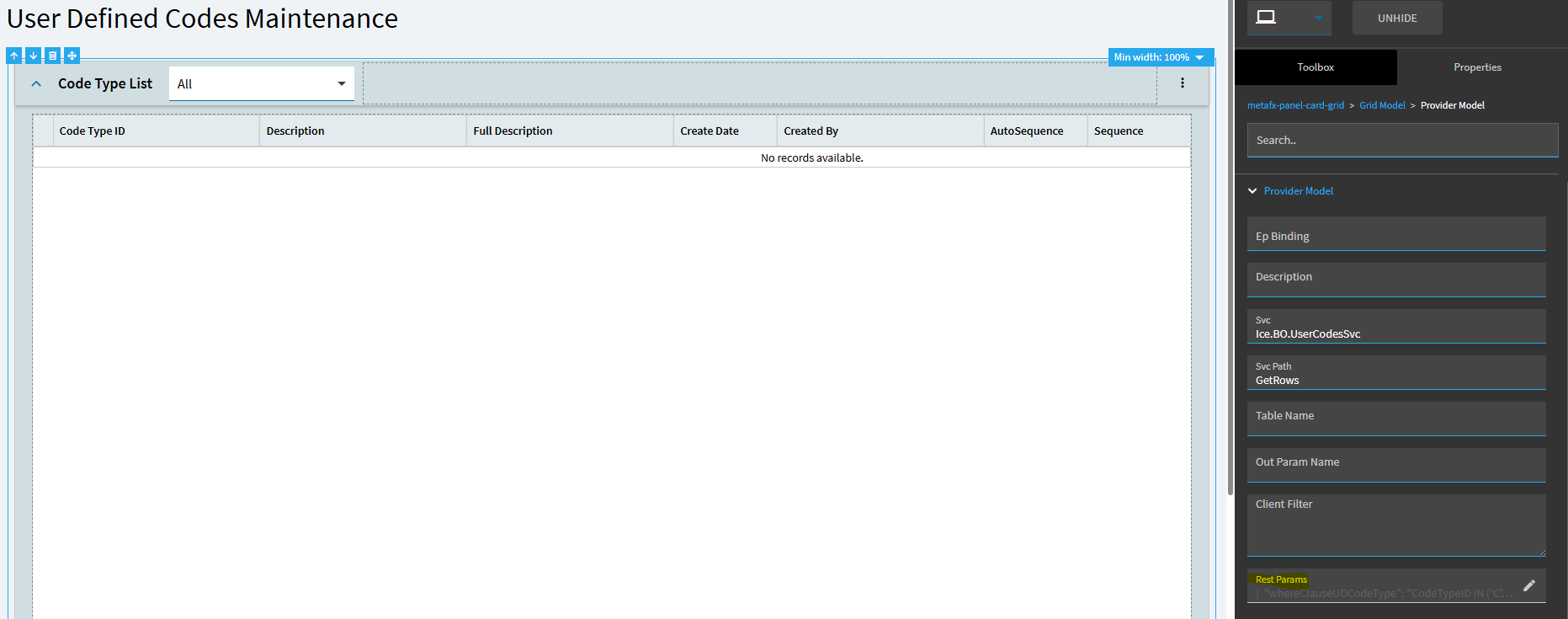

I created a new layer.
On the landing page grid, I went into the Grid Model > Provider Model and added a Rest Params “where clause”:
The below are the only code types I wanted to grant them access to:

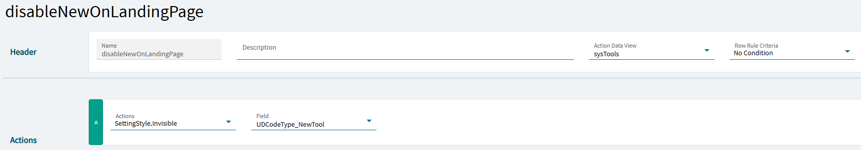

I also added a data rule to set the “new” code-type tool to invisible so they couldn’t create new code types.

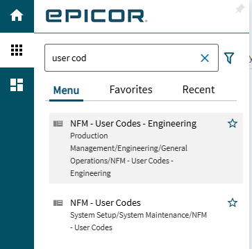

I then published that layer… added a new menu with that layer applied and put it in a folder my Engineers had access to.
So, I now have the standard “User Codes” menu that I use… and an “User Codes - Engineering” menu that they can get to. They only see the Code Types I said they could see, can’t add new ones, but they can edit/create new codes under those code types only.
