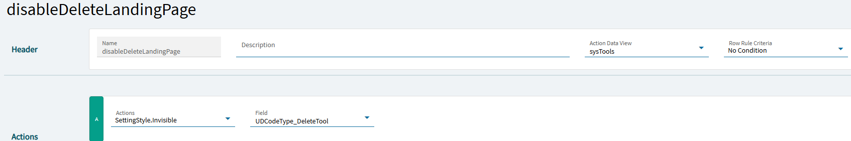

Good call… I did this customization awhile ago… I did account for those, but forgot to mention it above.

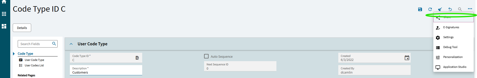

I hid the search box on the landing page form:
and disabled the search tool:
And also had a data rule for the UDCodeType_DeleteTool.
All do-able.

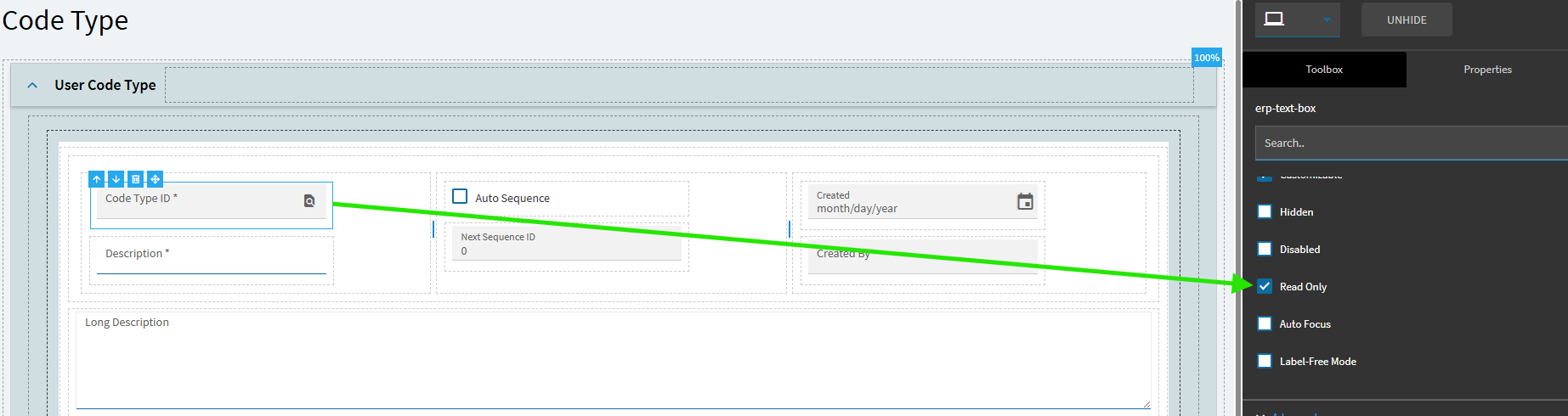

There is still the search on the Code Type field on the Code Type page, but even if the search is removed the user can still type in a code type they shouldn’t have access to, and it will then display it for them to add/change/delete codes. I tried using Advanced > Pattern on the Code Type ID field (“Force input to match this regular expression”), and all it does is turn the the field label red when you call up a code that doesn’t match - the code entry still loads. (I don’t think that word “Force” means what you think it means.)
Maybe you could set the Code Type field to search only and then have a custom filtered search?
Not trying to nitpick - I’m just trying to run through the various scenarios in my own mind, so that employees won’t hax0r the mAiNFraMe. :slight_smile:
Just change that field to read-only on the form. Then… no typing in a different code type… and no search clicky.

Ah, perfect!
