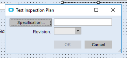

From what I understand, Attributes are loaded within a Configuration according to the SpecificationID linked to the PartNum being inspected.
When you test the configuration, it even asks you which SpecificationID you want to load the configuration under:
So the SpecificationID is extremely important to the configuration. Trouble is, within the code, you cannot identify what SpecID has been loaded :face_with_raised_eyebrow:

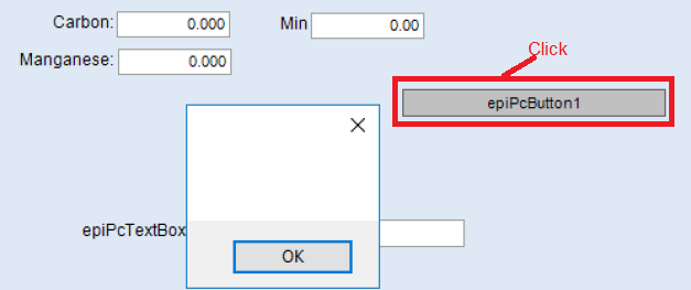

I even made a button, that simply has:
MessageBox.Show(Context.SpecificationID.ToString());
When it’s clicked, I want it to simply show me the SpecID… This what I get:
The kicker is, if I put in Context.CompanyID, Context.UserID, Context.SiteID etc. they all display. For some reason, the most important value to querying for an Inspection Planning configuration isn’t available. Is there anyone else out there that can get the SpecificationID? I also tried OnLoad and OnLoaded… blank there too…

You are correct about what the SpecID does for different Inspections. The trouble is, I need to know the SpecID chosen for my configuration so I can display some ReadOnly values to the user to help them in filling out the inspection. To-date: I have not figured out how to get the SpecID chosen. Which is quite surprising considering how important this value is to an Inspection Configuration. From my investigation, it looks like the SpecID simply isn’t available. Perhaps another upgrade will remedy this.

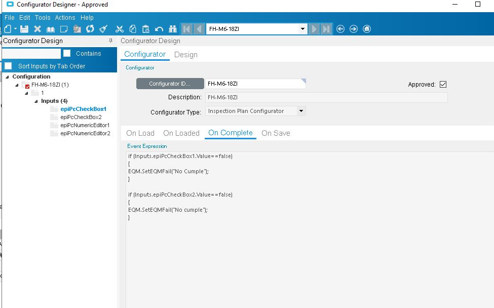

I didint saw that somebody answer, Epicare helped me
We only use Inspection plan, and it was about the checkbox failed formula event, now is working.
