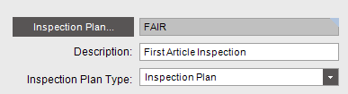

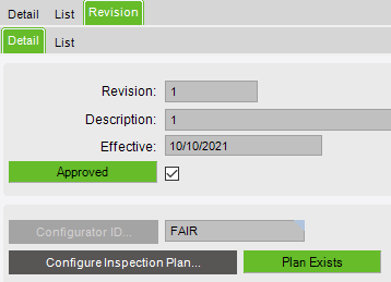

Next, create a generic Inspection Plan and Revision. As an example, I created a FAIR Inspection Plan and just made the Revision 1.

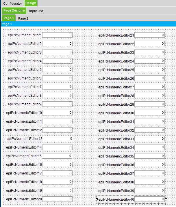

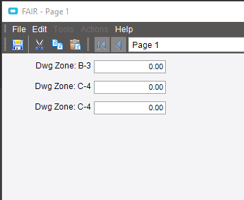

Next is to configure the Inspection Plan in the Configurator. I have one Configurator Designer with every attribute in it and it is very important to use the Inspection Attribute settings from the Specification.
While this does not make the Inspection Input screen all pretty, it does provide the ability to dynamically present the information required.

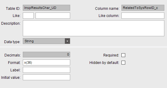

    The first thing we need to do is create a UD Column for every InspResultsXXX table. I called the column RelatedToSysRowID and set the field as a string.
Next thing we need to do is create a Method Directive and some Data Directives. The Method directive is on Erp.ConfigurationRuntime.PreStartConfiguration and is Post Processing. We are capturing the GUID of the InspResults row and saving it to a BPM Data Field. Then we need to create an In-Transaction Data Directive for each InspResultsXXX table to put the SysRowID we captured in the UD column we created.

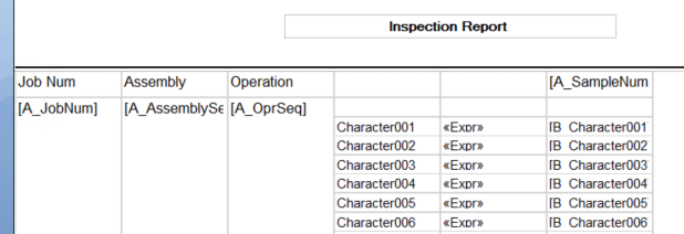

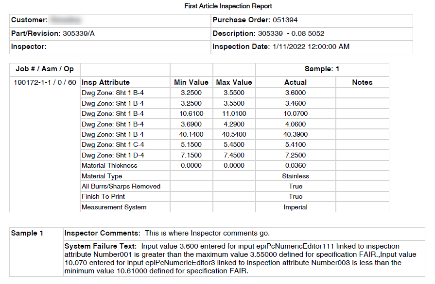

    Finally, create the Report Style and the SSRS report. As my inspections are for Jobs, I created the Matrix with 4 Row Groups and 2 Column Groups.
I then have 3 columns to display the results. The first column is the Inspection Attribute ID manually typed into each cell. The second column is an expression that looks up the value in the cell to the left to the InspSpec table to return the user entered Description.
=Lookup(ReportItems!Textbox9056.Value, Fields!SpecAttr_AttributeID.Value, Fields!SpecAttr_Description.Value, "InspSpec")
The last column is the inspection data. If there is more than 1 sample, the columns will grow to the right to accommodate them. The last piece is to put an expression in each row for visibility.
It is a ton of work to set up, but once it is done, you will have an Inspection Report that you can produce and send to a customer.
I am sure I missed something or poorly explained a step so I will probably edit this post at some point in the future, but wanted to get it out to everyone.
Nicely done sir! I’ve been contemplating a solution to the variable dataset across inspection plans and I like what you’ve done. And thank you for the write-up and sharing on the site.

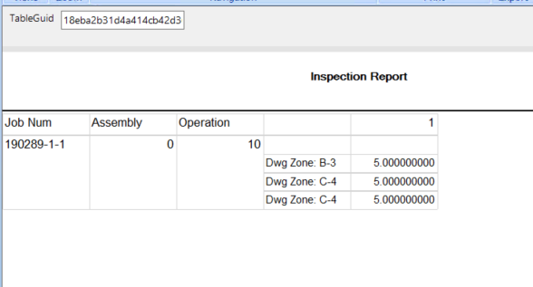

Here is what the SSRS report looks like. It is run based off of the Job number.

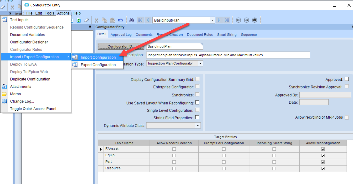

I am referring to importing the configuration in ā€œconfiguration entryā€.
it looks like you had created one with every attribute added to it.
I have not created one with every attribute added to it, I stopped at a few of the fields. Sorry.

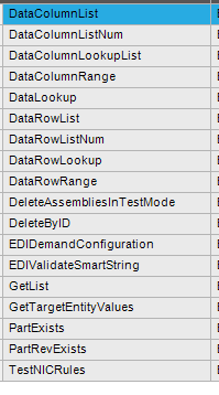

Is there an Equivalent to Erp.ConfigurationRuntime.PreStartConfiguration in 10.2.200.14?
I do not see that method under ConfigurationRuntime.
I am not sure as I don’t have that version
Hi Edgar, did you ever figure it out for your version?
