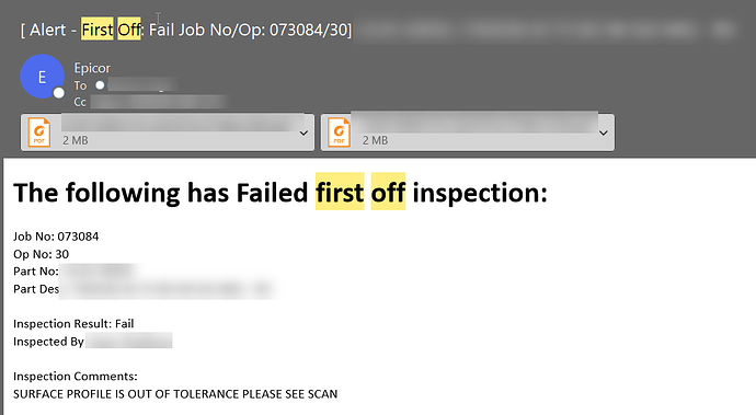

We did something with a BPM , it automatically builds the email and notifies the user the result along with the attachments the inspectors add.

// Initialize Variables
string EmailTO = "";
string EmailCC = "";
string EmailBCC = "";
string EmailSubject = "";
string EmailBody = "";
// Dictionary to store attachments (filename and stream)
Dictionary<string, Stream> attachments = new Dictionary<string, Stream>();
// Strings to store email addresses
string ResEmail = string.Empty; // Resource Email
string empEmail = string.Empty; // Employee Email
// Get the first row from the 'ttFirstArt' collection
var faiRow = ttFirstArt.FirstOrDefault();
if (faiRow != null)
// Retrieve the 'OpCode' from the 'Db.JobOper' table based on specific conditions
string opCode = Db.JobOper
.Where(a => a.Company == callContextClient.CurrentCompany &&
a.JobNum == faiRow.JobNum &&
a.AssemblySeq == faiRow.AssemblySeq &&
a.OprSeq == faiRow.OprSeq)
.Select(a => a.OpCode)
.FirstOrDefault();
// Get the 'FirstArtSvcContract' service to work with 'FirstArt' data
var svcFAI = Ice.Assemblies.ServiceRenderer.GetService<Erp.Contracts.FirstArtSvcContract>(this.Db);
if (svcFAI != null)
// Retrieve data from 'FirstArt' service using the 'SysRowID' from 'faiRow'
var dsFAI = svcFAI.GetBySysRowID(faiRow.SysRowID);
var faiResult = dsFAI.FirstArt.Select(r => r).FirstOrDefault();
if (faiResult != null)
// Set the 'status' based on a user-defined field 'FAIStatus_c' from 'faiResult'
string status = faiResult.UDField<System.String>("FAIStatus_c");
// Set the email targets by fetching email addresses from different tables
empEmail = (from row in Db.EmpBasic
where row.Company == faiRow.Company &&
row.DcdUserID == faiResult.EntryPerson
select row.EMailAddress)
.FirstOrDefault();
ResEmail = Db.Resource
.Where(a => a.Company == callContextClient.CurrentCompany && a.ResourceID == faiResult.ResourceID)
.Select(a => a.EmailAddress_c)
.FirstOrDefault();
// Set the email subject with specific information from 'faiRow' and 'faiResult'
EmailSubject = "[ Alert - First Off: " + status + " Job No/Op: " + faiRow.JobNum + "/" + faiRow.OprSeq.ToString() + "] " + faiResult.JobAsmPartNum + " / " + faiResult.JobAsmDescription;
// Prepare the email body with specific formatting and data from 'faiRow' and 'faiResult'
string color = status == "Pass" ? "Green" : "Red";
string header = @"<h1 style='background-color:" + color + ";'>" + "The following has " + status + "ed first off inspection:" + "</h1>";
EmailBody += string.Format(header);
EmailBody += "<body>";
EmailBody += "<p>";
EmailBody += string.Format("Job No: " + faiRow.JobNum);
// (Other email body lines)
EmailBody += "</p>";
EmailBody += "</body>";
// Fetch attached drawings using the 'DrawingsSvcContract' service and add them to 'attachments' dictionary
var svcDrg = Ice.Assemblies.ServiceRenderer.GetService<Erp.Contracts.DrawingsSvcContract>(this.Db);
if (svcDrg != null)
string whereClauseDrawings = "ForeignSysRowID = '" + faiResult.SysRowID + "' AND RelatedToFile = 'FirstArt'";
bool drgPgs;
var dsDrg = svcDrg.GetRows(whereClauseDrawings, 10, 0, out drgPgs);
if (dsDrg.Drawings.Count > 0)
foreach (var dwg in dsDrg.Drawings.Where(a => a.DocTypeID == "INSPEC"))
try
// Read the file content and create a stream to add to the attachments dictionary
var filename = dwg.FileName;
byte[] fileContents = File.ReadAllBytes(filename);
var stream = new MemoryStream(fileContents);
stream.Position = 0;
attachments.Add(dwg.DrawDesc, stream);
catch (Exception ex)
// Handle the exception (currently commented out)
// throw new BLException(ex.Message);
// Send the email using the 'mailer' and 'message' objects, along with attachments
var mailer = this.GetMailer(async: true);
var message = new Ice.Mail.SmtpMail();
message.SetFrom("");
message.SetTo(empEmail);
message.SetCC(ResEmail);
message.SetSubject(EmailSubject);
message.SetBody(EmailBody);
message.IsBodyHtml = true;
mailer.Send(message, attachments);
