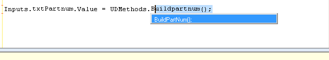

And just curious … Why does it suggest the proper capitalization, but pressing CTRL+Space yields all lower case?
Double clicking the suggestion, inserts the proper case. But the whole point is to use keyboard entry.
Is there a better way of choosing the suggestion via keyboard?

There are a number of annoying editing behavior issues in the configurator code editor. The auto complete is a bit case insensitive, so you can type inPuts or Inputs or INPUTS and the auto complete will come up for all of them. But when you are done you will get a syntax error due to the incorrect case of the object name.
Another annoyance, if there is text to the right of what you are entering when you select something it will eat that code.
… Key1, Key2). If you type something where Key1 is and use the auto complete to select an item, the comma at a minimum will get eaten.
I know I should report more of these but I have gotten used to working around them and if on a schedule forget to submit when I get time.
another is when you select something after typing part of the item it will add onto what you typed. So Inputs.txtMy becomes Inputs.txtMytxtMyControl
