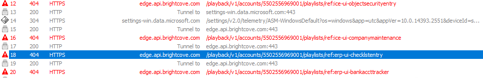

3 – I am in the middle of still troubleshooting but one thing that really caught my eye was this from ProcMon – not entirely sure what this call is quiet yet but will know soon. You will notice the process is Epicor that is encountering this TCP reconnect.
4 – Any version 10.2 and earlier works fine.
5 - A bunch of attempted Azure traffic
