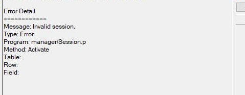

It’s mostly “Invalid Session” errors, like this:
