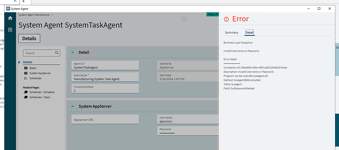

I am trying to replace credential for the system agent but I am getting the error below:

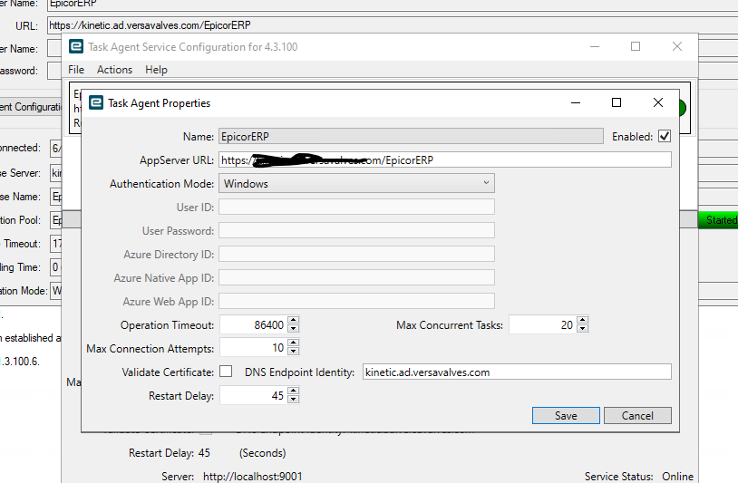

OK, if the credentials are known to be good, check the Task Agent setup then. URL could be off or Authentication Mode. Or you just typed the password wrong.

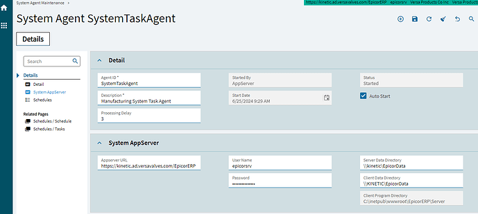

is the user account entry set up with the proper domain name and username for windows?
Yes, that is correct.
throw the app server URL in that system agent maybe?

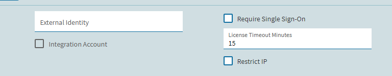

Also for the user do you need to diable SSO then? Or make sure that the user is not limited to SSO only?

I tried using domain\username nut still getting the error.
Can you confirm that the 2024 task agent service is running as this same user? That would not be the default option.
I am using windows authentication for the task agent and i am logged into the system using the same account use in system agent.
But is the Task Agent SERVICE logged in as that same account on the server? Check in services and see what account it’s using. The default is to run as Local System Account which does not have a matching Windows user I would imagine. The LogOn tab for the service would need to be the specific user account you are trying to tie to this Epicor account if you’re going to use a Windows endpoint.
The trick was to reset the password for the service account, and login using basic authentication to set up the edge agent.
