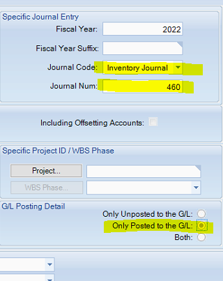

@Laurie To follow up on what @todd.mcgregor mentioned there are hundreds of ways to use the wip recon report to get details on the periodic posting entries.
If you have a particular entry from the GL Report with a journal and seq on the right hand side is the Specific Journal section. Captures are code IJ so you want Inventory Journal and the Seq is the Journal Num. make sure to mark only posted or both or you will get nothing. Also in your system monitor turn on notification balloons, so you will get a notification when a report is empty. Nothing more frustrating than having a report not show up because your parameters produced no results.

@gpayne Thank you so much for all your help.
I was able to get the report I needed and I can trace it all back to the finance statements.
