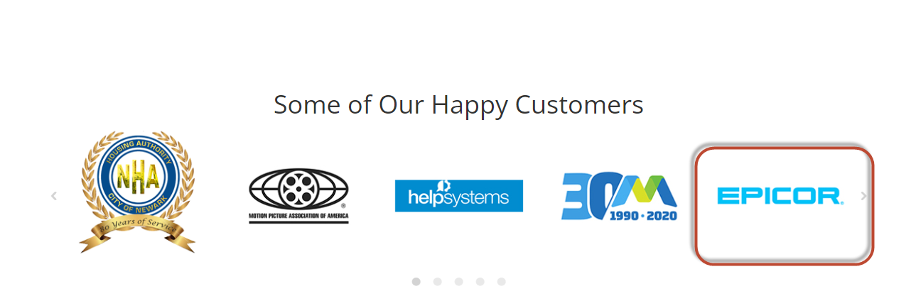

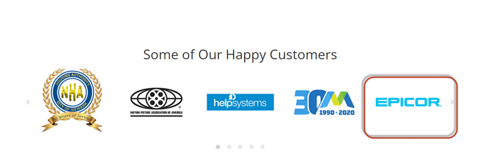

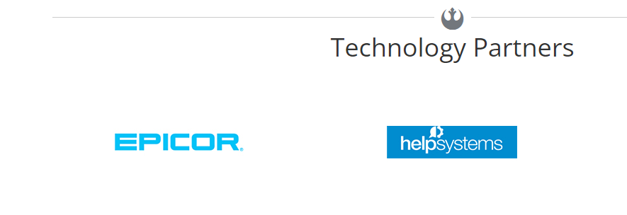

Is epicor ECM (docstar) and Ancora Software the same thing? We currently use Docuphase as an document management system. Our parent company is looking to implement Ancora for some automation and i was wondering if its the same thing the docstar uses for its automation. I noticed on Ancoras website they have epicor listed as a partner.
