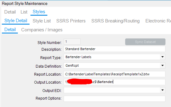

Sure. Just use the report style to dump a csv to a network location and have BarTender pick it up.
Yes it is.

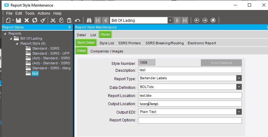

You can generate a .bt file from any report. I think…
Example of BOL:
However I would first start to use Dynamic Reports the new way to BAQ Reports with proper filters.
Mr. John: Thank you for the suggestion. I did not know we could do that.
However, this instance is on an Epicor Cloud and I get an error when i try to write to the Epicor Server.
Unauthorized Server Path.
Any suggestions
UNC Paths are not allowed in Report Options. On-Prem has the same.

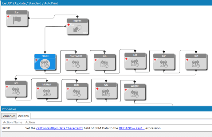

I have a data directive that runs an Autoprint.

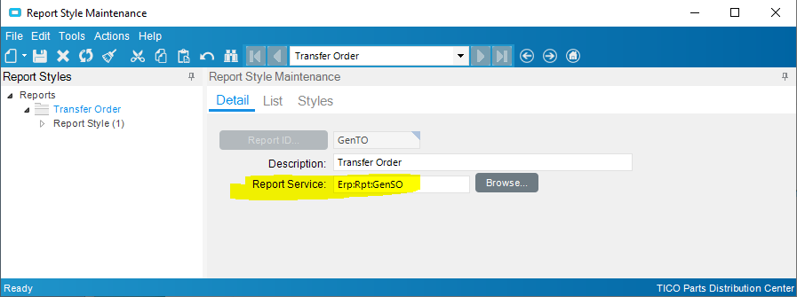

I think the root problem is that no Report Service exists for a report that I just created. Or does it?

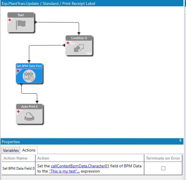

Mr. Jason: I updated the AutoPrint BPM to create a comma delimited list in the ClientBPMData that holds all of my UD12 information.
It was a band-aide - but it is working. I needed something and waiting for Epicor to fix (or get that working) was not an option.

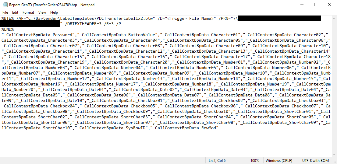

I’m still curious how you accomplished that.
I get the BPM headers, but no data for them:

Here is a screenshot of the AutoPrint BPM that i am using:
Sorry: It looks like i am assigning the data to generic fields in the ClientBPMData.
I have also, done this for others where I created a comma delimited list that i parsed in Bartender.
Doing it this way makes assigning fields in Bartender a little easier.
Please remember - this is just a workaround to get the job done.
DaveO
Well that’s what I took you to mean anyway. And I am completely fine with that. Everything I do every day is a workaround.
But I must be missing something because I am getting no data.
I did try to assign one like you did:

This is blowing my mind by the way:
What, um, language is that? I guess it is for BarTender to decode?
Mr. Jason: Maybe that is my problem - i was not able to find a Report Service for UD12. I see there is a report service avail for GenInv, and GenRcpt.
I can only assume i tried those and could not get them to work? Or maybe they work now - but did not when i needed them.

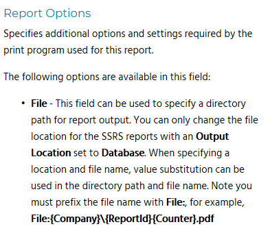

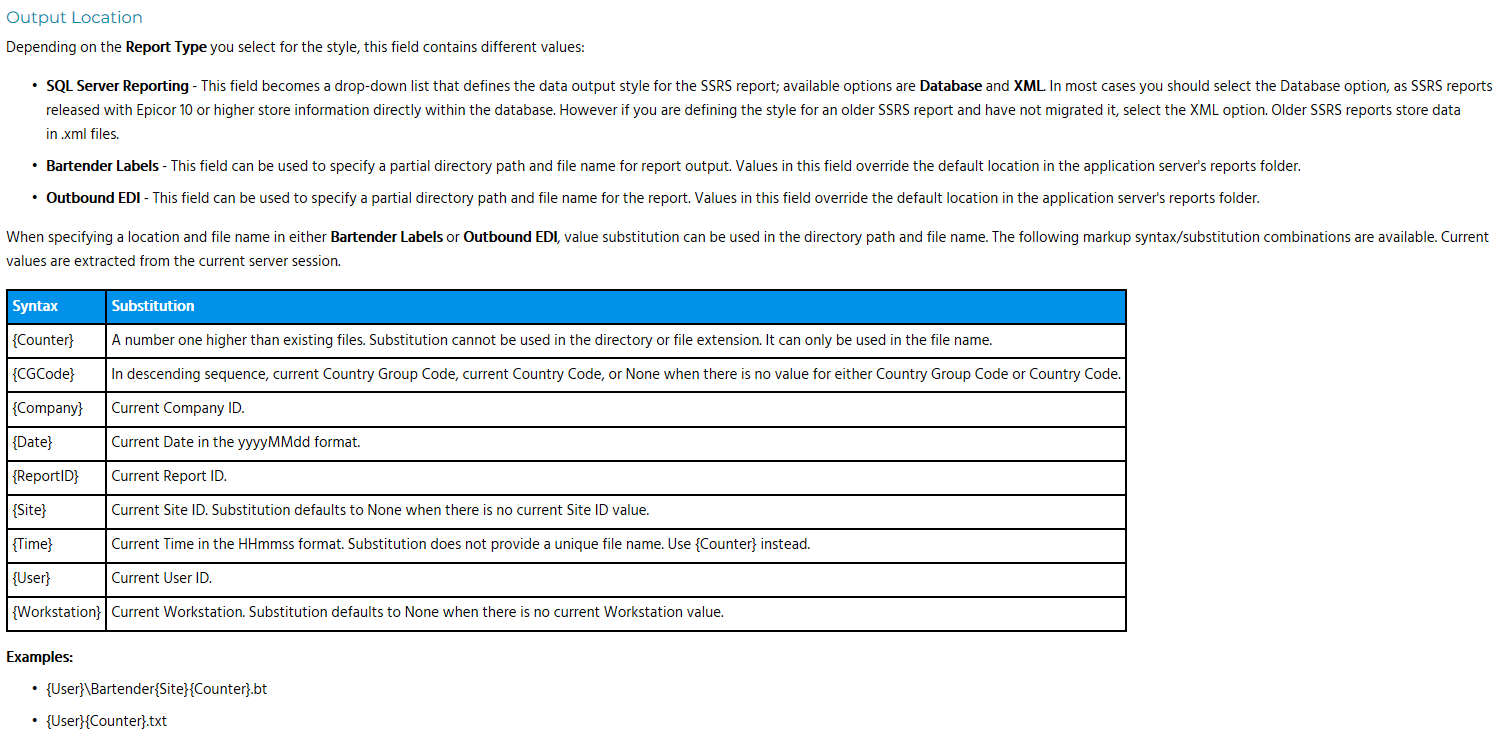

That is actually Epicor functionality. From help
Alright, I switched it to that.

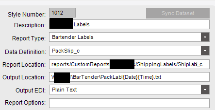

One thing I did notice though is that you are missing the SSRSRenderForm. Also I think you need the file type at the end of the Output Location. Mine is a .txt
So, for standard BarTender labels, neither is necessary:
