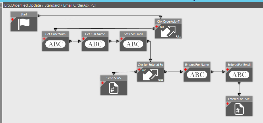

Ok, a little on the OCD here, but in BAQ designer you can use the arrow keys to move the selected table around the page to line up the joins. Is there a similar function in the BPM designer?
Nope… those of us that are OCD about alignment just need to get our satisfaction from manually aligning all the boxes and lines using the mouse. Sometimes they become pieces of art!! here is one of my finer works:

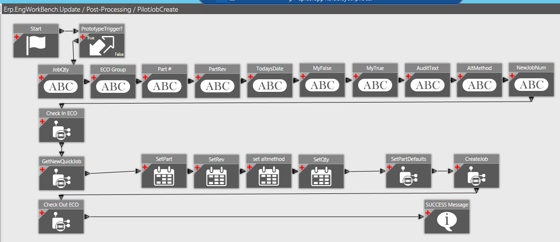

FYI… this BPM is a 100% widget BPM that calls FIVE standard Business Objects…
the function is quite amazing too… its function:
Trigger: Check a box on the ECO rev Header to say that you want a “Prototype Job” for your part.
Actions:
- approves and checks in the revision
- uses QuickJob to create a new job for this part/revision, and GETS DETAILS from the new rev.
- Unapproves and Checks the part back out to the ECO Workbench.
- Pops a message (telling you the new job number if i remember right).
It does all this in just a few seconds (as opposed to taking several minutes to do this manually)

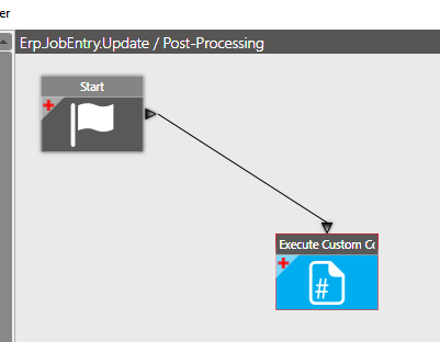

I think you’re right! If you look closely at Jose’s picture, you’ll notice most of the boxes have the thin red (not configured) border and only the Execute Custom Code does not.
