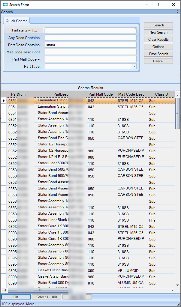

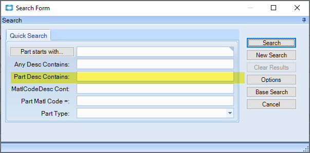

Hi Shawn,
We did this using an External Query. I am not sure why (maybe pure SQL vs BAQ SQL’ish?) is the reason it works. MATCHES PER BELOW makes the search work on partial text entry without user needing to add % or anything. We have UD field for “material code” info too, so that’s why I have a concatenated description calculated for Match on part desc or the UD desc too.
One drawback is that I use this as default part search. On part searches that are actually part rev search I needed to instruct users to click for base search.
Nancy
