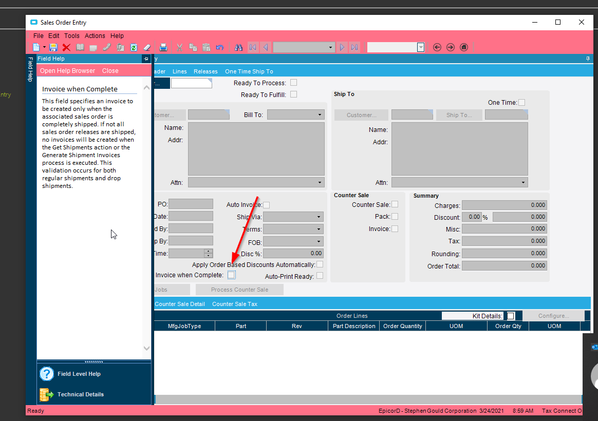

Is there a way to set up a company to only bill after multiple shipments complete a sales order?
Hello,
Don’t know much about the shipment/invoicing aspect, so I thought I would ask here.
I was asked if there was a way to not invoice shipments until the final shipment completes the order. Hoping there is a checkbox somewhere for that, just couldn’t find it :slight_smile: .
Any help is appreciated.
Thanks,
Shawn
It’s on the sales order.
There is a similar setting on the Customer, which makes it a default for all Sales Order for that customer.
Vinay Kamboj
That is what I was looking for! Thanks for the quick response!
And Thanks to @Vinaykamboj for the Customer tip, I will pass that along as well.
