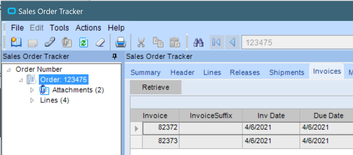

We have 2 invoices for 1 shipment(1 pack slip), and don’t want this(we want 1 invoice). I’ve checked all the fields I know that govern this and they seem to be set as we expect. Can someone point us in the right direction? See screenshots / explanations of where we’ve looked below.

2 Invoices

@Aaron_Moreng good question. When I print preview both invoices(not sure where to see this elsewhere), all lines are listed on the first invoice, and the second invoice is blank. Any ideas why we would have a blank invoice?

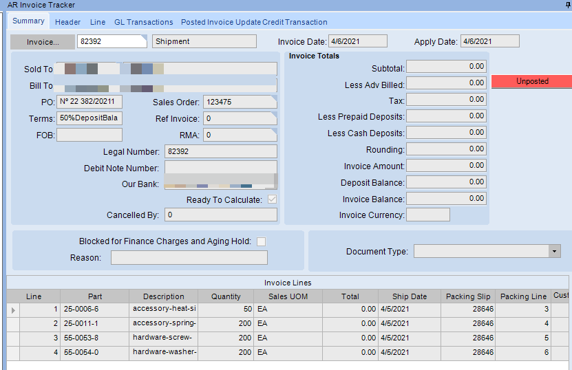

We also deleted both invoices and did “get shipments” but it created two invoices again. Below are the Order Totals and Both Invoices. The blank one is $0…

It looks like the first invoice, 82392, has packing slip lines 3 - 6 on it. What does invoice 82393 have? Were there lines 1 and 2 on the packing slip?

  • Using Get Shipments in Invoice Entry creates 2 separate Invoices

  • The invoice that has a zero dollar total only has the sales kit’s components.
Does the non-zero invoice have the sales kit parent item as a line item?
