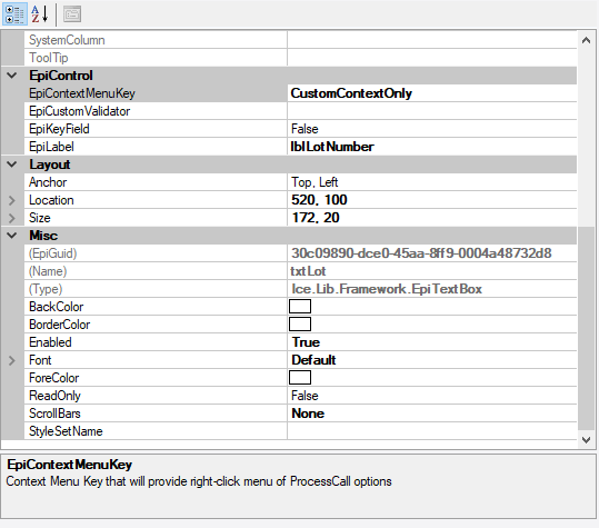

Trying to stop users from right-clicking their way to ‘Lot Search’ from the Issue Material screen in MES and randomly selecting lots. Any better suggestions on how to stop them from doing this?
Have you looked at Context Menu Maintenance off the main menu?
A few possibilities to do this for just the Issue Material screen:
Customization: Hide the lot field off-screen, add another text box in front of the panel, and have the lot field filled on Text Changed event of the new field.
Process Calling Maintenance: have Lot Search call a menu item that does nothing only when called from the Issue Material screen. You would also need to apply this to Lot Tracker and Lot Entry when called from Issue Material.
Context menu maintenance for individual users, but this affects every occurrence of Lot Number.
A good caning for non-compliant users…
Yes, I have, but I am unsure how to figure out for sure which Context Menu it’s using. I’ve also tried changing it to other values I saw in the Context Menu maintenance, and I have tried clearing out the entries for LotSelectUpdate.LotNum et al. I guess I don’t know what CustomContextOnly means???
James, #4 was my suggestion back when they asked me to hide the Lot Number button (which also triggered the search). Now it’s personal because they’ve outsmarted me with a right-click!!!
