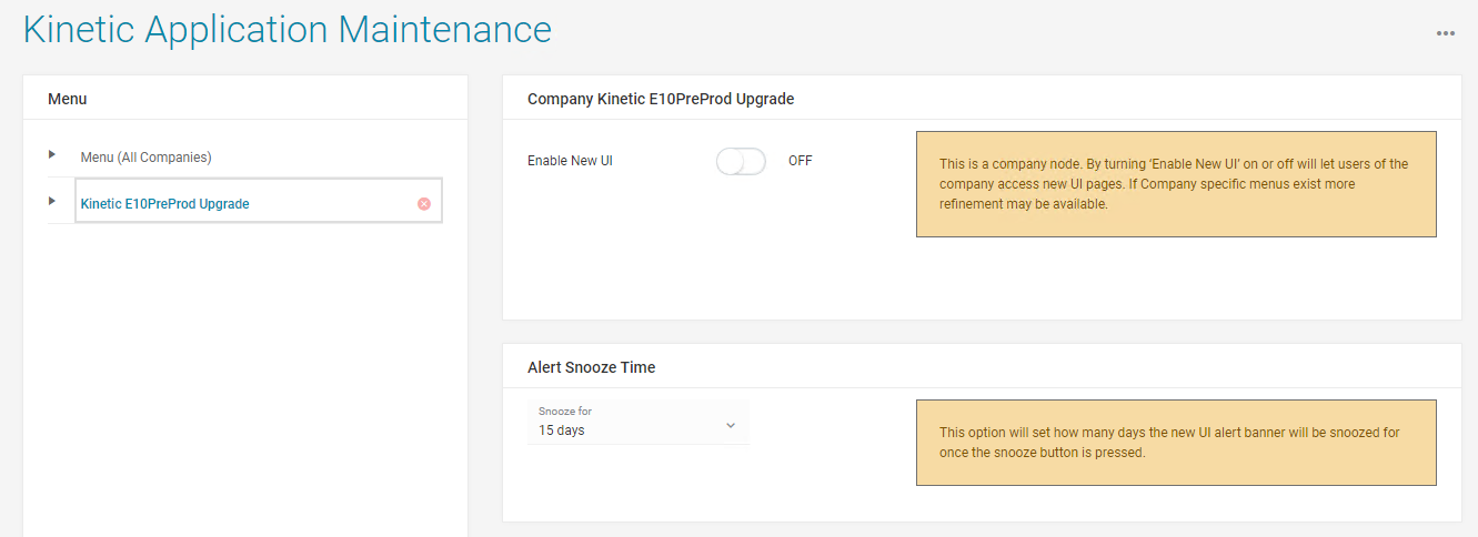

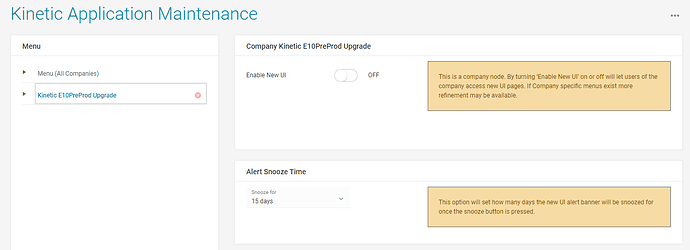

Don’t you just disable Enble New UI option in Kinetic Application Maintenance?
I may have dabbled a bit with that…
There is some more complete info and the gotchas in there by the other users.
They removed that screen from the newer version of cloud kinetic it seems.
I try and do a search for it and when I type kinetic there are no options.
I am set as security manager and didnt help.
We just went from 2021 to 2022 and it was removed from 2022.2. It was an option in 2021.2.
