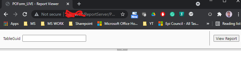

GenerateReportPDF(“http://EXCO-ERP10-SQL.excoeng.com/ReportServer/ReportExecution2005.asmx”,reportStyle,tableguid,FileName);
Seems that one of the values is coming in blank but the system is expecting a txt/xml file?

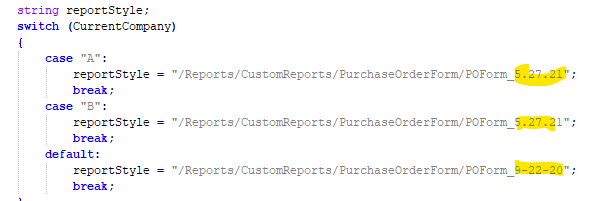

string FileName = String.Format(@"C:\Epicor\ERP10.2Client\ExcoClient\PrintReports\{0}.pdf", PONUM);
string reportStyle;
switch (CurrentCompany)
case "A":
reportStyle = "/Reports/CustomReports/PurchaseOrderForm/POForm_5.27.21";
break;
case "B":
break;
default:
reportStyle = "/Reports/CustomReports/PurchaseOrderForm/POForm_9-22-20";
break;
GenerateReportPDF("xxxx/ReportServer/ReportExecution2005.asmx",reportStyle,tableguid,FileName);

ok so that seems to get rid of the last error…now its saying that the path to my report item isn’t valid…
The path of the item ‘/Reports/CustomReports/PurchaseOrderForm/POForm_9-22-20’ is not valid. The full path must be less than 260 characters long; other restrictions apply. If the report server is in native mode, the path must start with slash
I know that is the correct location…missing something easy I am sure…appreciate all the back and forth on this Lawson
I noticed that your working code posted is for the Sales order Acknowledgment…did you ever apply it to the PO entry form?
Yeah I do have it in PO Entry but modified to send from Epicor and not Outlook,
I can see a couple of things, the last code snippet I sent had an extra " on the end of it, try removing that
it should be like this
rsExec.Url = "http://EXCO-ERP10-SQL.excoeng.com/ReportServer/ReportExecution2005.asmx";
Also are you developing this in LIVE or a Test environment, if Test, do you have the same forms in Test as in Live
Also is the form name correct, your naming convention changes between forms (dots to dashes)
Try pasting this into a web browser
If the form name is correct it should take you to a screen like this
SQL.excoeng.com/ReportServer/ReportExecution2005.asmx?/Reports/CustomReports/PurchaseOrderForm/POForm_9-22-20](http://exco-erp10-sql.excoeng.com/ReportServer/ReportExecution2005.asmx?/Reports/CustomReports/PurchaseOrderForm/POForm_9-22-20)
This is not showing report viewer…gives me an error…
Its strange as well…because shortly after I clear the error, I get confirmation the PO generated and it shows in the system monitor…but if I try to preview from there it won’t even give me the option too…
Something wrong with your path…
What do you get when you follow this link
that pulls up some XML code in the browser…asks for the user and password before it loads…
Good, that means that part of the path is correct, what is the error you get with the previous post?
