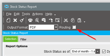

Autoemailing PO by enabling the printing routing rules was successful. But I would like to prereview/edit the email content - before sending it to the respective supplier…
Uncheck the Routing box
That gets checked automatically when the reports style has an enabled Break routing. Unchecking the box makes it ignore the break routing. But you’d lose any of the detail the break routing adds.
What you could do is duplicate the report style, and its break routing. Then chge it so that it is only sent to you. Add the fields that you would have sent it to to the body, so you can se how they would have populated.
Thanks for replying Calvin.
1)unchecking the routing box it just open up the PDF document.
2)Duplicated the report style and updated the changes so that I received the email with the PO attached but again i have to do lot of editing. Adding suppliers email IDs,  deleting the unwanted content etc.
I want to just pop up the outlook new message with the content of PO attached and supplier email ID’s. Later I will do the necessary edit and would like to manually click the send button of that email.
