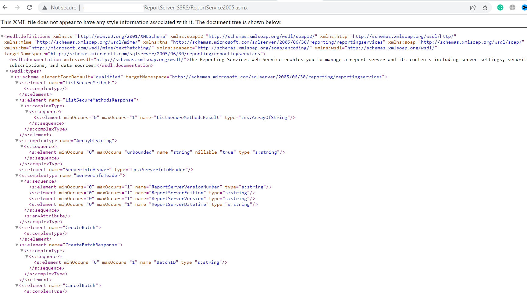

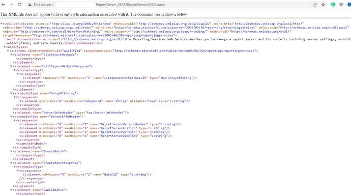

http://exco-erp10-sql.excoeng.com/ReportServer/ReportExecution2005.asmx?/Reports/CustomReports/PurchaseOrderForm/POForm_9-22-20
I get this error:
  • The item ‘/Reports/CustomReports/PurchaseOrderForm/POForm_9-22-20’ cannot be found. (rsItemNotFound)
ok, can you try apending one of the other form name to the url instead of _9-22-20

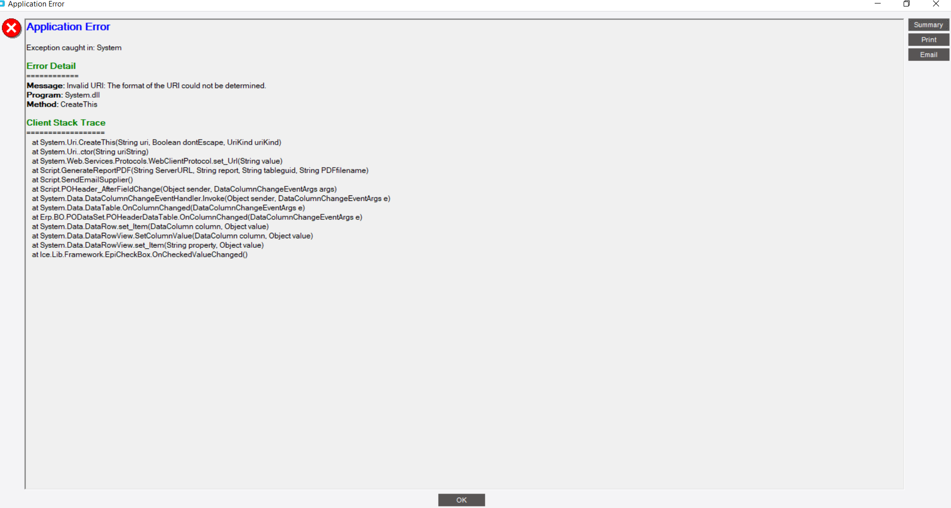

Ok So I just realized there is another directory path ahead of the /reports…
I tired it last night thinking that was the problem but it still gave me an error…but I just noticed I had an extra // which was the issue…now I get to the Tableguid…so let me update my code and see if that fixes it
Urgh…now I am getting a new error ha ha this is going to be the death of me…

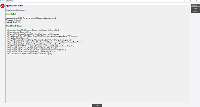

Application Error
Exception caught in: mscorlib
Error Detail
Message: The network path was not found.
Program: CommonLanguageRuntimeLibrary
Method: WinIOError
Client Stack Trace
   at System.IO.__Error.WinIOError(Int32 errorCode, String maybeFullPath)
   at System.IO.FileStream.Init(String path, FileMode mode, FileAccess access, Int32 rights, Boolean useRights, FileShare share, Int32 bufferSize, FileOptions options, SECURITY_ATTRIBUTES secAttrs, String msgPath, Boolean bFromProxy, Boolean useLongPath, Boolean checkHost)
   at System.IO.FileStream..ctor(String path, FileMode mode, FileAccess access, FileShare share, Int32 bufferSize, FileOptions options, String msgPath, Boolean bFromProxy, Boolean useLongPath, Boolean checkHost)
   at System.IO.File.InternalWriteAllBytes(String path, Byte[] bytes, Boolean checkHost)
   at System.IO.File.WriteAllBytes(String path, Byte[] bytes)
   at Script.GenerateReportPDF(String ServerURL, String report, String tableguid, String PDFfilename)
   at Script.epiButtonC1_Click(Object sender, EventArgs args)
   at System.Windows.Forms.Control.OnClick(EventArgs e)
   at Infragistics.Win.Misc.UltraButtonBase.OnClick(EventArgs e)
   at Ice.Lib.Framework.EpiButton.OnClick(EventArgs e)
   at Infragistics.Win.Misc.UltraButton.OnMouseUp(MouseEventArgs e)
   at Ice.Lib.Framework.EpiButton.OnMouseUp(MouseEventArgs e)
   at System.Windows.Forms.Control.WmMouseUp(Message& m, MouseButtons button, Int32 clicks)
   at System.Windows.Forms.Control.WndProc(Message& m)
   at System.Windows.Forms.Control.ControlNativeWindow.OnMessage(Message& m)
   at System.Windows.Forms.Control.ControlNativeWindow.WndProc(Message& m)
   at System.Windows.Forms.NativeWindow.Callback(IntPtr hWnd, Int32 msg, IntPtr wparam, IntPtr lparam)
Ok so I have eliminated the errors…I changed the location that the PDF is being saved to my local drive…and the PDF is being created (finally). However, Outlook seems to be the issue now. After a few mins and email DOES show up in my drafts, so it is doing something…with the correct PO number and contact info…but no attachment and its not showing my the draft when its being created…so I am getting closer!
Yeah, was gonna say that this is refering to a local path on your PC… I have this pointing to a shared drive on a local server
string FileName = String.Format(@"C:\Epicor\ERP10.2Client\ExcoClient\PrintReports\{0}.pdf", PONUM);

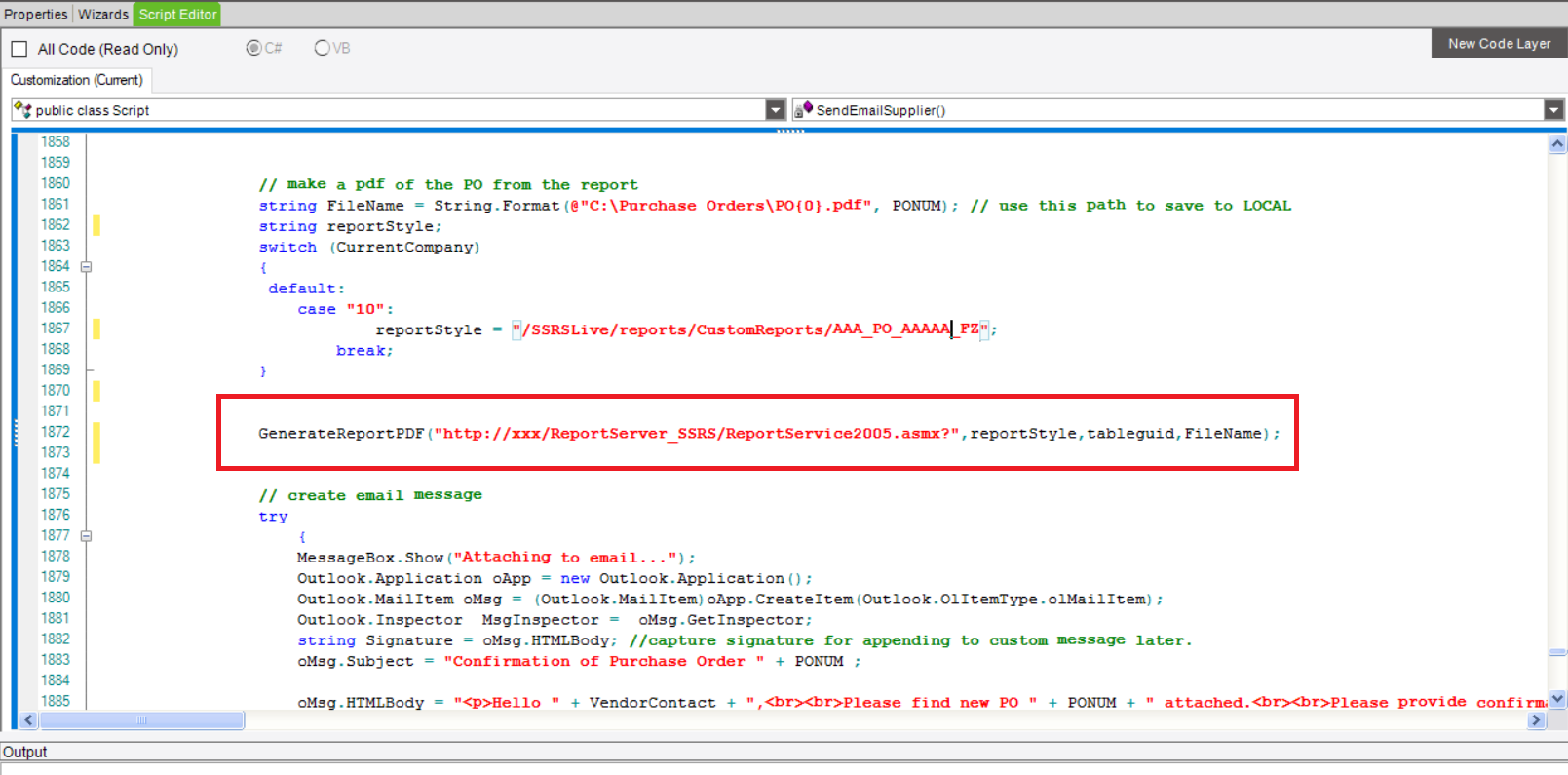

    private void GenerateReportPDF(String ServerURL, String report, String tableguid, String PDFfilename)
            // setup report variables
            string deviceInfo = null;
            string extension = String.Empty;
            string mimeType = String.Empty;
            string encoding = String.Empty;
            Warning[] warnings = null;
            string[] streamIDs = null;
            string historyId = null;
            // Create a Report Execution object
            Microsoft.Reporting.WebForms.Internal.Soap.ReportingServices2005.Execution.ReportExecutionService rsExec = new ReportExecutionService();
			rsExec.Credentials = System.Net.CredentialCache.DefaultCredentials;
            rsExec.Url = "/ReportServer/ReportExecution2005.asmx";
            // Load the report
            rsExec.LoadReport(report, historyId);
            // pass parameters
            rsExec.SetExecutionParameters(
            new ParameterValue[] { new ParameterValue() { Name = "TableGuid", Value = tableguid } }, null);
            // get pdf of report
            Byte[] results = rsExec.Render("PDF", deviceInfo,
                out extension, out encoding,
                out mimeType, out warnings, out streamIDs);
            File.WriteAllBytes(PDFfilename, results);

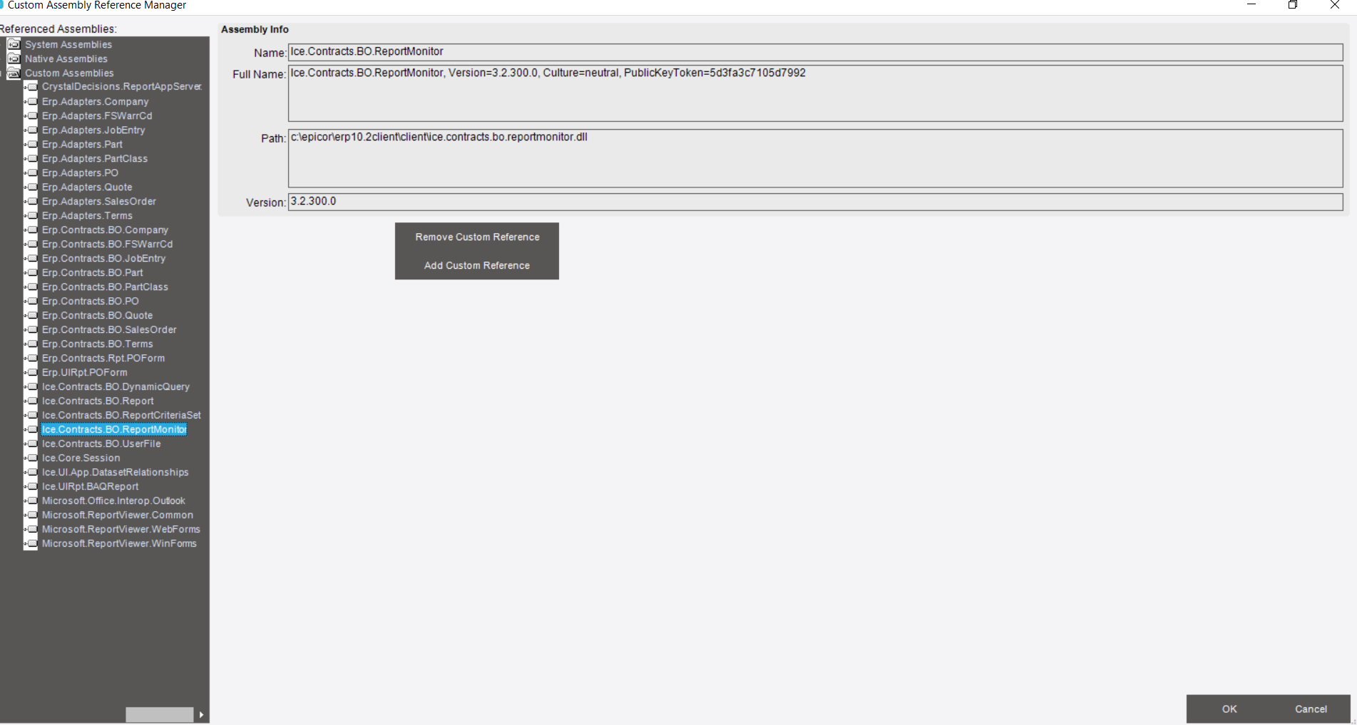

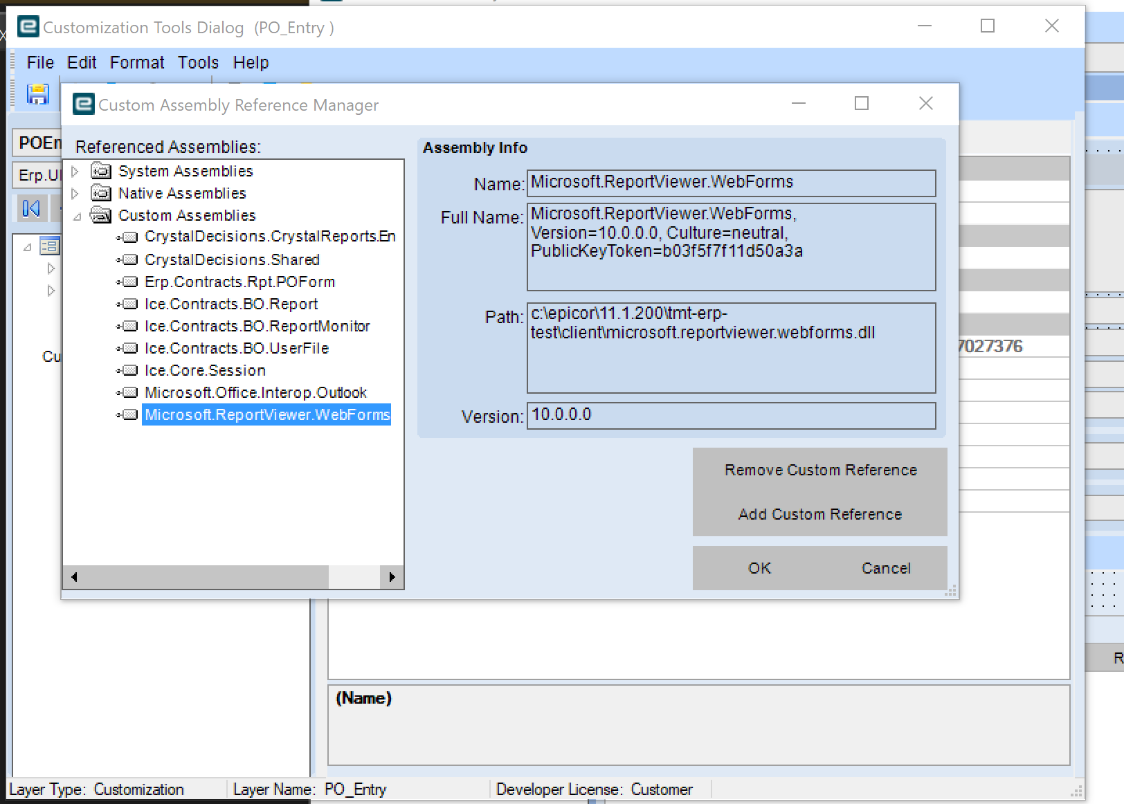

@LBARKER & @bmanners i’m getting below error after adding using Microsoft.Reporting.WebForms.Internal.Soap.ReportingServices2005.Execution;
Error: CS0234 - line 66 (66) - The type or namespace name ‘Internal’ does not exist in the namespace ‘Microsoft.Reporting.WebForms’ (are you missing an assembly reference?)
Naveen
You will need to add the assembly file to the client and add a reference to the file in the customisation.
Also note that this kind of customisation will not be possible in the Kinetic UI and as the desktop client is going away in the not too distant future you will get a limited life span out of this.
Hi @bmanners ,
I added to version 8 DLL, so it does not work. now changed to version 10 it’s working Thanks.
Hi @bmanners / @LBARKER ,
one more error:
Error: CS0246 - line 1836 (3795) - The type or namespace name ‘SysRptLstListDataSet’ could not be found (are you missing a using directive or an assembly reference?)
Naveen
Check you have the same assembly references as my screenshot…You might be missing the ReportMonitor one??
Brett
@bmanners Please find the below screenshot, already there.

try adding below using to the code.
using Ice.BO;
@bmanners Its worked :blush:
Now one more error :
Invalid URI: The format of the URI could not be determined.
below screenshot generatereportpdf getting error.
Naveen
I am guessing your report server is not called “xxx”. Put the correct server name in there instead.
Brett
@bmanners its not xxx. while pasting here, I changed as xxx.
the reportingservice is connecting.
@LBARKER @bmanners
Error : Invalid URI: The format of the URI could not be determined. kindly check and help on this
