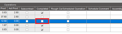

The operation has been completed the required quantity but the Completed checkbox is not ticked.
In Job Status Dashboard found the Opr Completed and checkbox is tick.
But we can’t find the related record for the Employee for the date in Time and Expense screen. But the data is in sql.
Please advice. How can i retrieve back the record.

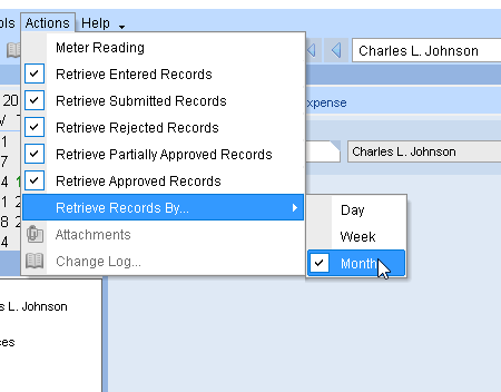

Assuming you have employee selected, did you check these?
Hi Chris,
Yes, i checked this but still unable to find the job detail.
