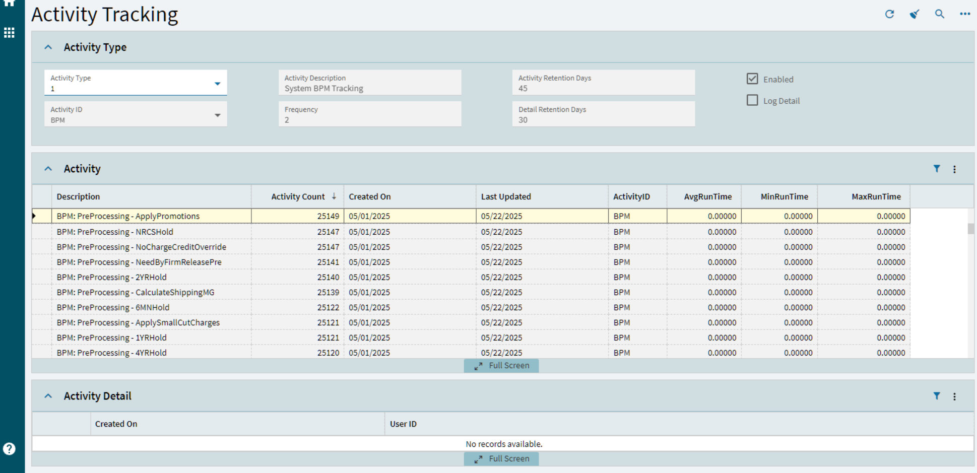

@aosemwengie1 - Great idea! How are you using activity tracking to see execution times? All my BPM runtimes are 0.00000.
I think I mistyped that, its the BAQs that show the runtime.
