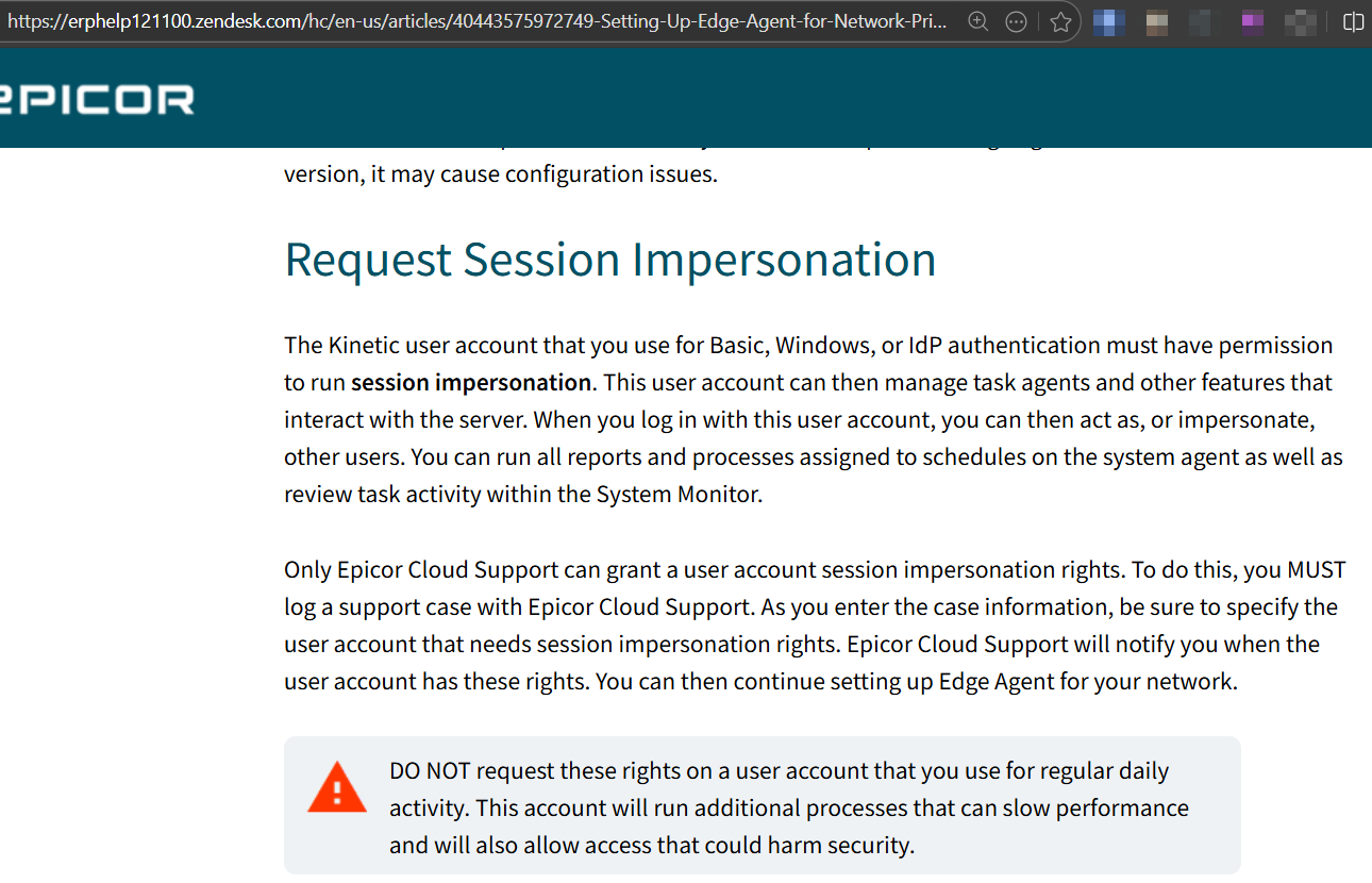

It’s more explicit now.
That’s nice. It should still be something a security manager can do without having to log a support case. Its just adding hassle for no reason.
Make sure you get that in as a support ticket.
I have, but have been getting the run around a bit.
