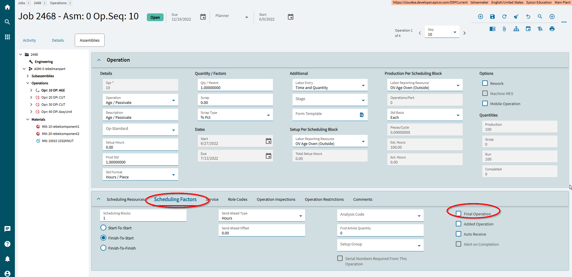

Apparently, they were just moved to a location that none of us knew, under Scheduling Factors!
Yes this was moved due to the need to have more room to have the tabs below. I dont have a firm date for the change, but I believe it happened at or before 2023.1. No significant changes have been made to the job screens since then.

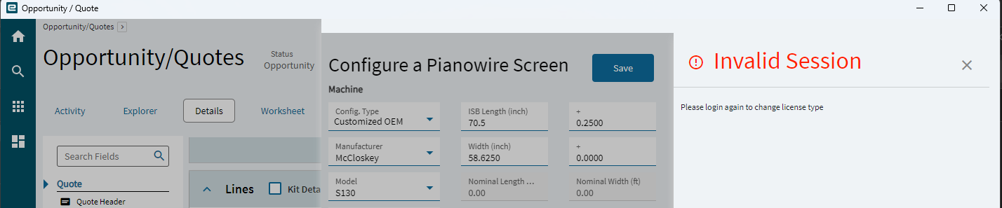

I think this issue is killing me – any updates? I can open my app just fine if I use the menu item directly but I can’t get any version of the app-open widget to work..

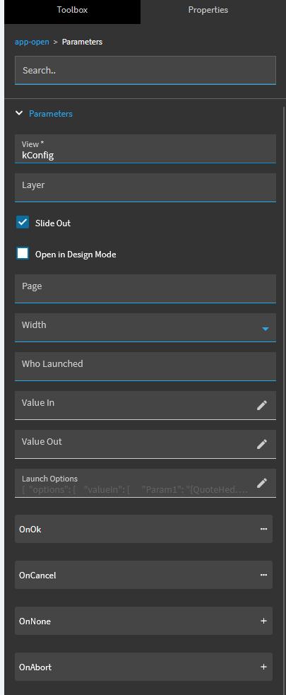

Unfortunately, I have had complete radio silence from the Epicor Support technical team. Our issues were in MES, but to get us working with a temporary workaround, I converted from using the MenuID to using the Kinetic Application and Kinetic Customization (layer). This bypasses the menu security, which isn’t a huge concern for us, but is something to keep in mind if you choose this method. Also, removing any customization layers from the menu item seems to work as well.
I am using a menu item for a kinetic screen, no customization. I have tried using the menu item and the view name in the app-open widget and neither work although they change the error somewhat. If I click on the menu by hand it works, but I need it to open from the quote screen with some values sent in. This all works fine under a full license but not CRM. Very frustrating, I spent 50 minutes on the phone with support and their solution ended up just buy more full licenses :face_with_symbols_on_mouth:
Yeah, it has been very frustrating dealing with all the issues and having no response from technical support. Using the Ice.UIDbd.dashboardName in the app-open Parameter > View and then using the Layer name in the app-open Parameter > Layer fields are how I got around our issues. Not sure what errors you are getting, but if you post those on here, someone may be able to help you figure it out.
