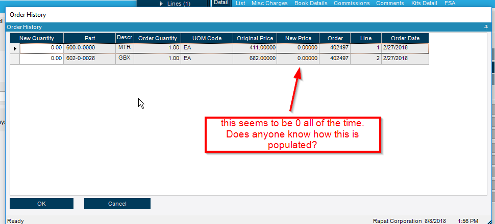

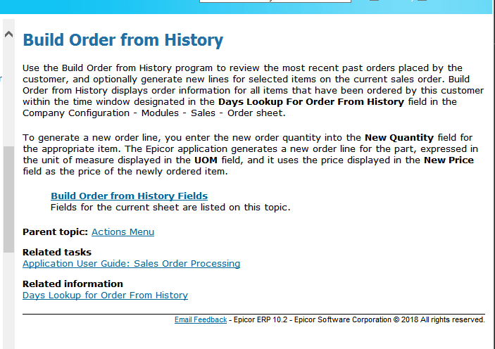

Now that I say that, I’m looking at it in our test system and the “new price” is always 0 for the orders I’ve looked at. This is what gets populated on the order line. Does anyone know what populates the new price field? Help is less than helpful.
OK, that price comes from the price list. Wow, that is a lot of set up to manage the price lists. Is there a mass update for those? Or would that be a DMT thing?
